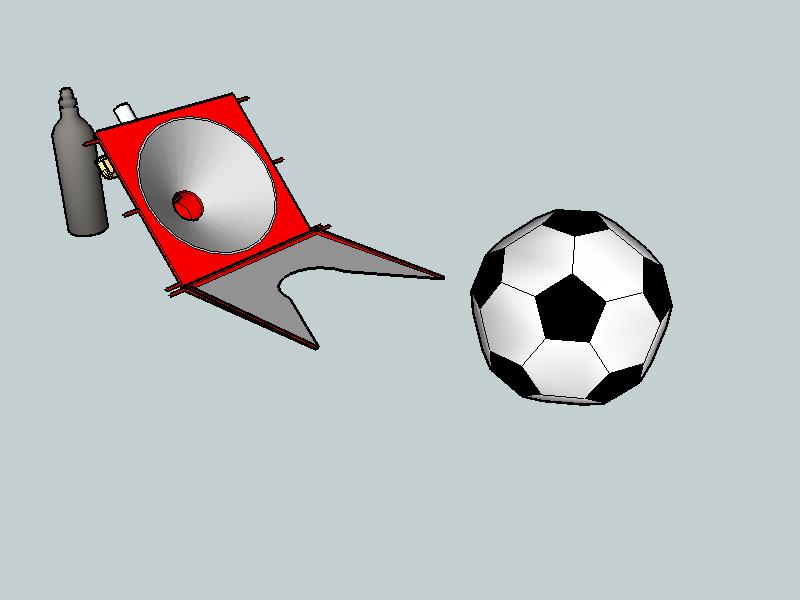

Just follow the pictures- Pretty much self-explanatory
- Launch
- RSBLL.JPG (22.92 KiB) Viewed 4661 times

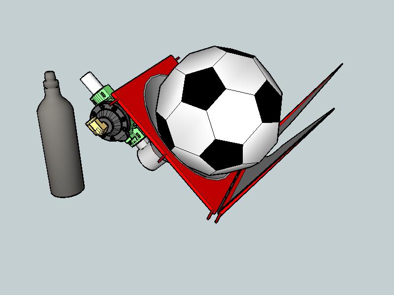

- #4 - Catcher rotates, to dump ball in funnel mouth
- RSBL4.JPG (37.43 KiB) Viewed 4661 times

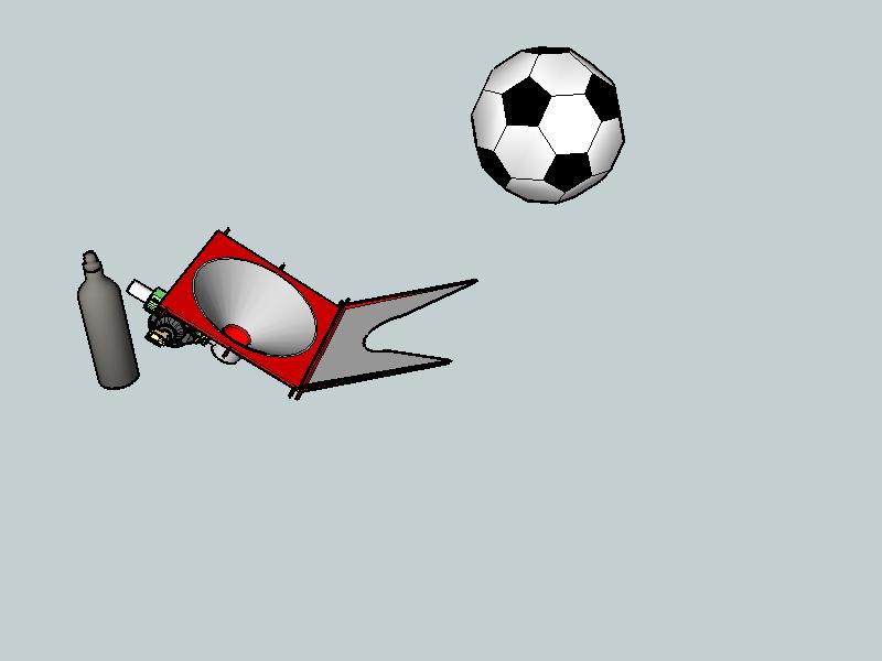

- #3 - Ball is caught in catcher
- RSBL3.JPG (39.55 KiB) Viewed 4661 times

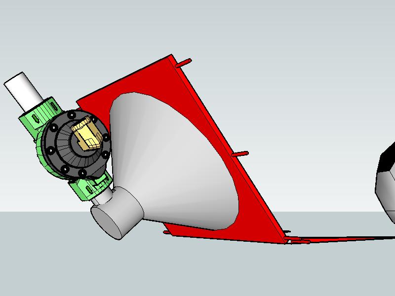

- #2 - Catcher has a funnel-shape, with a 1" Modified Sprinkler Valve, at the base
- RSBL2.JPG (38.84 KiB) Viewed 4661 times

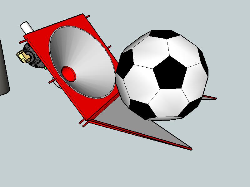

- #1 - Ball will be "swept" into catcher
- RSBL1.JPG (28.1 KiB) Viewed 4661 times
