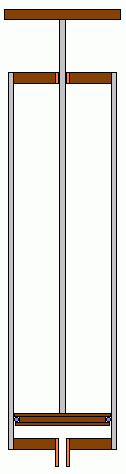

Hello, I am thinking about giving my hybrid another round of small updates. Not to make it more impressive but to make it more user friendly.
The first thing I need is a syringe like object big enough to fuel a 7.359l chamber.
That would be a 3300ml syringe, now I am not asking specifically about a syringe but perhaps something that can be used in the same manner as one.
Ideas?

A cheap bike pump dismantled and modified to fill in the notches that let air through on the pump head
Mon Feb 28, 2011 12:42 am
Why not just make your own? As it's not really pressure bearing you can make it out of PVC pipe, araldite and balsa wood, at least that's what I would do ;)

I think jack's got about the right idea. Use a graduated cylinder to measure out 3300 mL of water, draw into your big ass homemade syringe, and mark the fluid level with a marker or pen.
EDIT: forgot to add, a good construction material would be any cheap plastic tubing (like acrylic). A plunger can be fashioned with some threaded rod, washers, and sheet rubber. The end of your syringe can be some 1/4" copper tubing cast into the end of the acrylic tube with some epoxy and tape spacers.
That's exactly what I had in mind if I didn't get a simpler solution here, I hate movable seals!
That's also exactly what I thought, I will suck in the required amount of water and mark the plunger rod 1X, 2X, 3X and so on.

SpudFarm wrote:That's also exactly what I thought, I will suck in the required amount of water and mark the plunger rod 1X, 2X, 3X and so on.
No need to get things wet, it's fairly easy to calculate the volume of cylinders ;)
