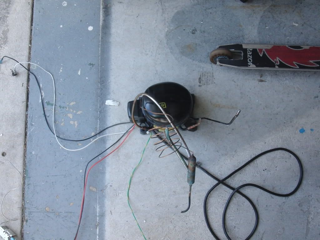

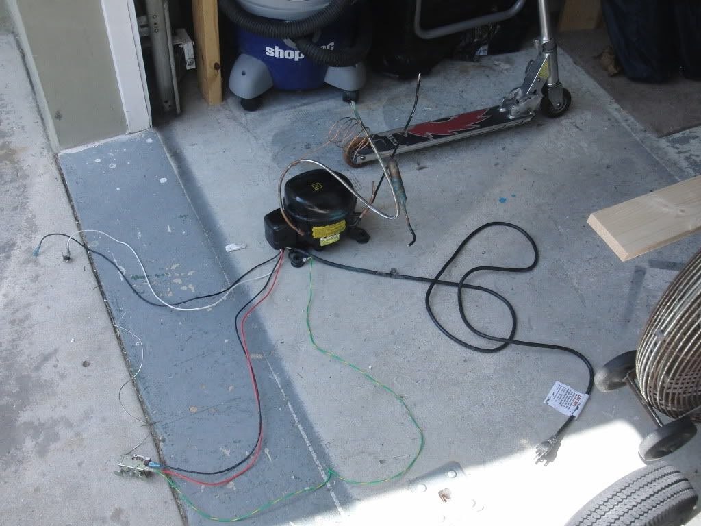

I finally ripped the fridgy out of a water cooler thats been sitting in my garage forever. There are a ton of wires and tubes coming off of it. But as far as I know, all I need is the power, input, and output, is this right?
Here are some pics

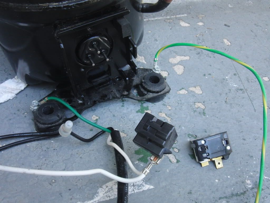

I pulled the little cover thing off and this is there. What do I do here?
Sun Jul 31, 2011 1:46 pm
lol why did you remove all the wires ?? it was ok in the first place... I hope you remember where each wire was attached
the red and white wires (as wel as ground) lead to the thermostate... you should cut them off and put your on/off switch there
the black and white wires probably were to power a lightbulb or something like that so you can remove them

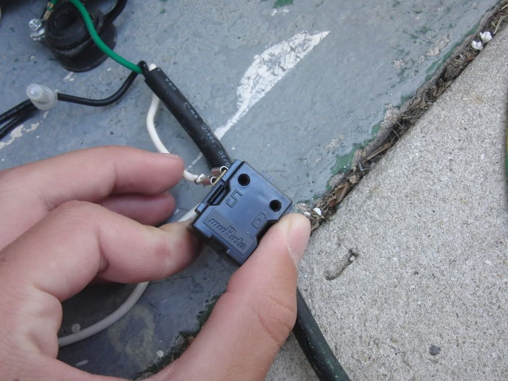

Sun Jul 31, 2011 2:50 pm
The block that plugs into the compressor's 3 pins is the starter. This is required to properly start the compressor. Put it back on and wire to it, not the compressor directly.

Poland, I remember where they all go lol.
You mean red and black, right? Then the black and white ones I don't need?
Tech, cool, I'll go put it back together. I was taking everything out just to see what was there. I'm like that :tongue3:

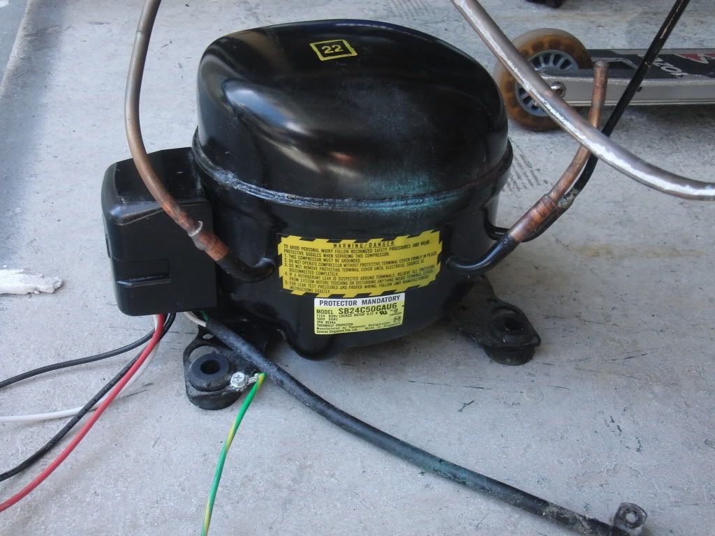

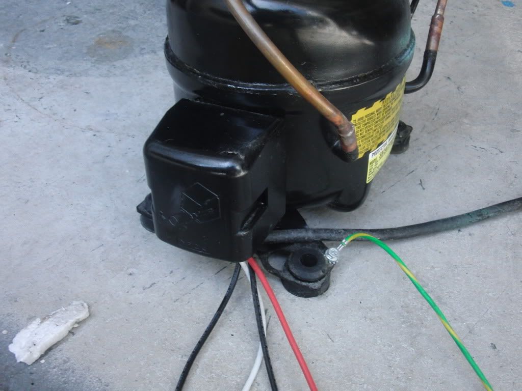

I wish to ground my fridgy. :lol:
How do I ground it? The green wire is the one connected to the compressor base, so I think it's the ground, so what do I wire it to?
here it's already done... the green wire is attached to the case
the other end of that wire is connected to the grounding prong in the plug - so you don't have to do anything - it's already done duhh

No there is a green wire and a green and yellow wire. The two wires in that last pic are different. As of now the green and yellow wire is just hanging off. Is the pure green one that runs out of the power chord the only wire that needs to be connected to the base for it to be grounded? If so can I remove the green and yellow one?
I hooked up a toggle switch to the black and red wires and left a black and white wire hanging. It works so ha! Lol. It isn't compressing out the copper though, it's coming out the black tube. Is that supposed to happen?
