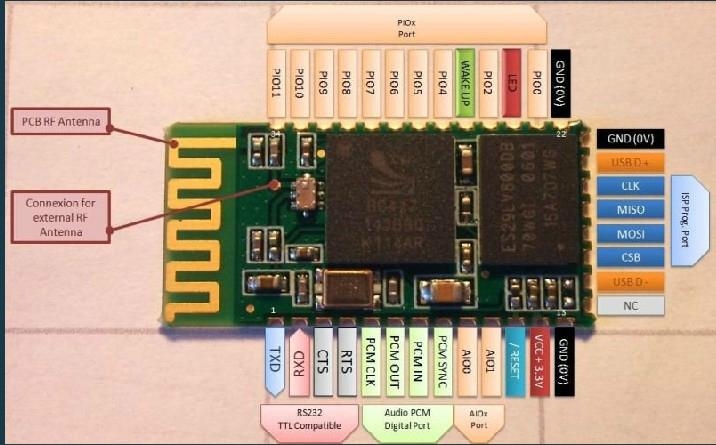

Guess what - I've done some research and I found this -> http://www.oemblue.com/Bluetooth%20Audi ... odule.html
and then this ->
Well I always wondered what are the other connectors for on all of these modules...
so in other words it might be easier than we thought
EDIT
ohh tech and have a look at the datasheet too ->
https://www.bluetooth.org/tpg/RefNotes/ ... 1_V01D.pdf
It seems there are programmable IOs too - not sure if I understand that correctly but apparently one wouldn't even need a microcontroller to turn on/off a few relays

and then this ->
EDIT
(I am reffering here to the thread on remote ignition modules)
Thanks. Looks like I will be reading alot of info. Hoped for a prebuilt module that would interface a blue tooth headset to my radio with minor tweaking. Radio just has standard analog mic/speaker jacks. Wanted to use a manual push to talk setup.
