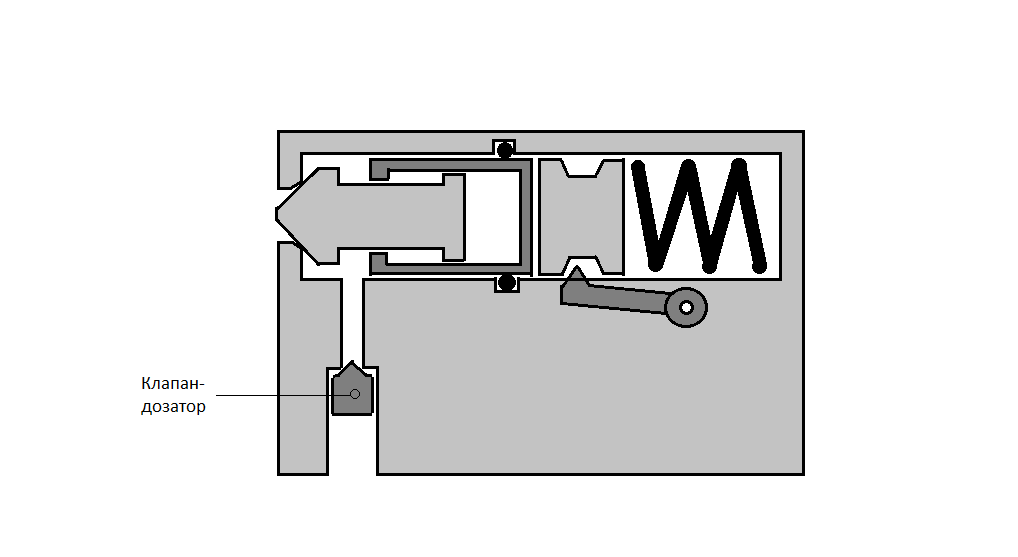

Hi guys. I want to ask a little stupid question. How do you call such a valve in your language? Image We called it "self-opening" (самооткрывашка). On Russian sites I read everything about him, even did those, but I have little information. I need the correct translation to more accurately set the search query in Google. :oops:
Do you mean something like this?
This thread might be of interest: http://www.spudfiles.com/pneumatic-cann ... ml#p381298

jackssmirkingrevenge wrote:Do you mean something like this?
I know this valve, HUBEN1. My friends and I studied it a lot and actively, an excellent valve, but it is difficult to manufacture it, we need machines. I have seen many similar schemes, such a valve is sometimes used in multicompressive pneumatics. In any case, thanks for the answer.
I had made something similar before investing in machining facilities, using part of a syringe as the piston.
Here is the thread: http://www.spudfiles.com/pneumatic-cann ... c7457.html
