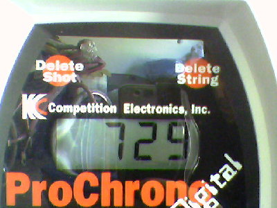

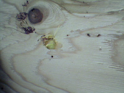

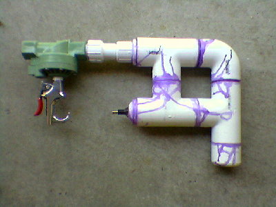

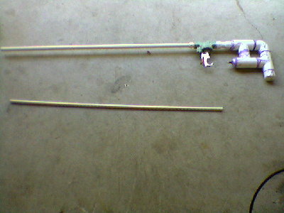

I tested at 120 psi. Here are some pics of my gun and stuff.
My pneumatic cannon. Uses a 3/4" cpvc barrel to fire paintballs.
Messy job.
Messy job.
Shot a paintball at 120 psi. This is in feets per second.
1/2" thick Plywood.
1/2" thick Plywood.

I think the reason they are only rated to 90 psi is because they have the little nozzle on the end. You probably removed it, so you should be fine, even at high pressures. NICE gun, too! 729 fps... AWESOME! :D

Pilgrimman wrote:NICE gun, too! 729 fps... AWESOME! :D
Thanks.
