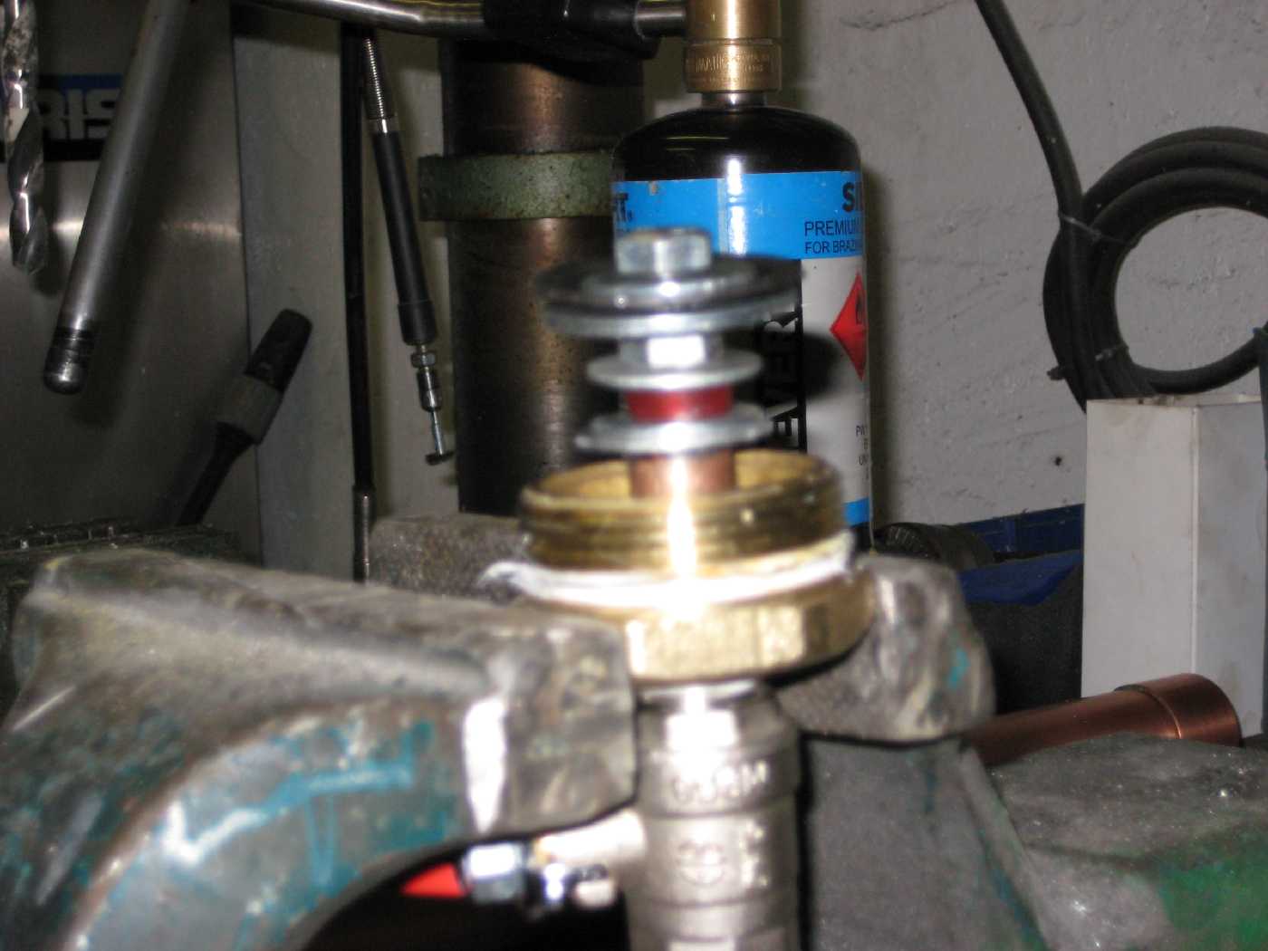

like the pic, there is: a sealing face, something behind it to support the thin rubber face, something to seal in the housing so it can pilot, o-rings are best, a guide rod to prevent it to flip, a bumper to soften the impact of the piston as it smacks into the housing and the pilot valve.

you need a sealing face, a pretty long screw, a fitting to attach a pilot valve, some steel washers, a nut and some air. (mabe o-rings and rubber hose)
you do like this: first you put a steel washer onto your screw that is a tiny bit smaller than your seat.
then you put your sealing face on.
after that you put on a steel washer in the back of your sealing face that is the same size as the housing.
on the back of the big washer you put a smaller one. if the hole in the big washer is to big for your nut.
then you screw the nut on until you can notice your sealing face start to bend a bit. the last touch is to close your pilot valve and screw it on the way you want it into to your fitting that connects the pilot valve to the housing and drop the bolt in to make sure that it not touches anything in there. if it does cut small pieces of it until it doesn't.
bumper for advanced pistons:
you can find a small washer that fits on you guiderod (the unused part of the screw) and put it on.
then you find a rubber hose that fits your guidingrod and drop it on, when you have done that you drop one more washer on the other side of the hose and put a tight o-ring or something on the back of your last washer to stop it from gliding of you guiderod and there you go!

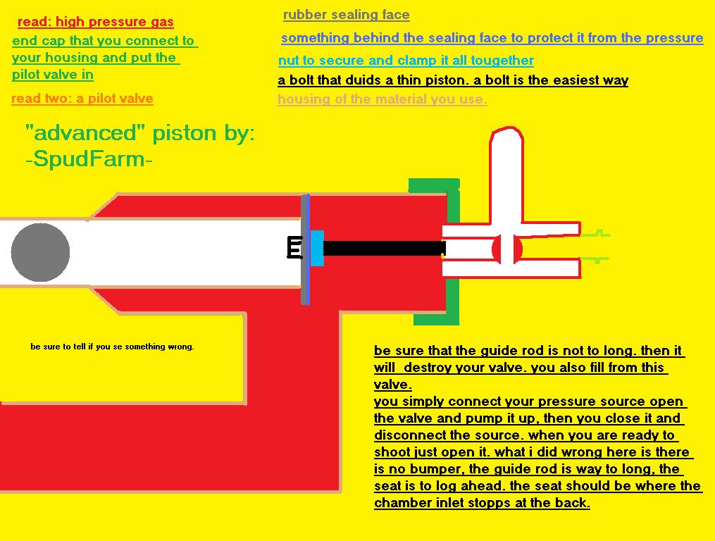

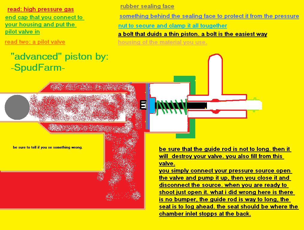

this is the valve open. i have added a bumper there.

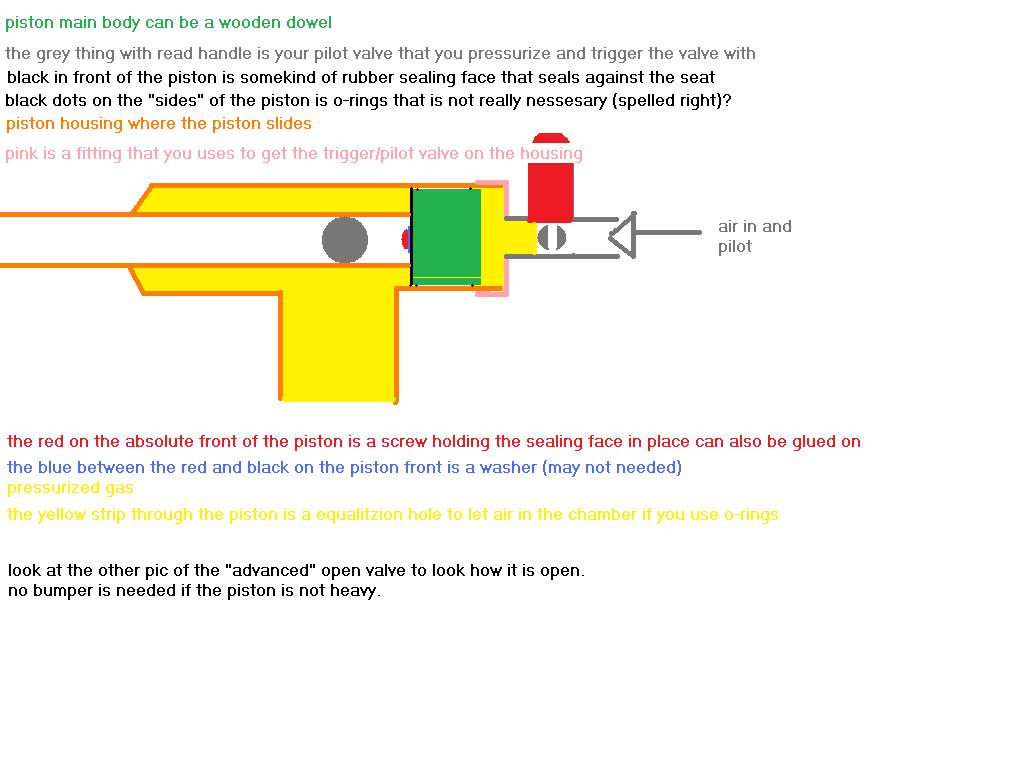

this is the simplest version of the valve.
advanced piston number two.<br />not much to say other than note words and details

small and better pic of the easy piston.<br />may want to look for any detail and note words so you know what i write above
easy piston2.jpg (26.65 KiB) Viewed 4356 times

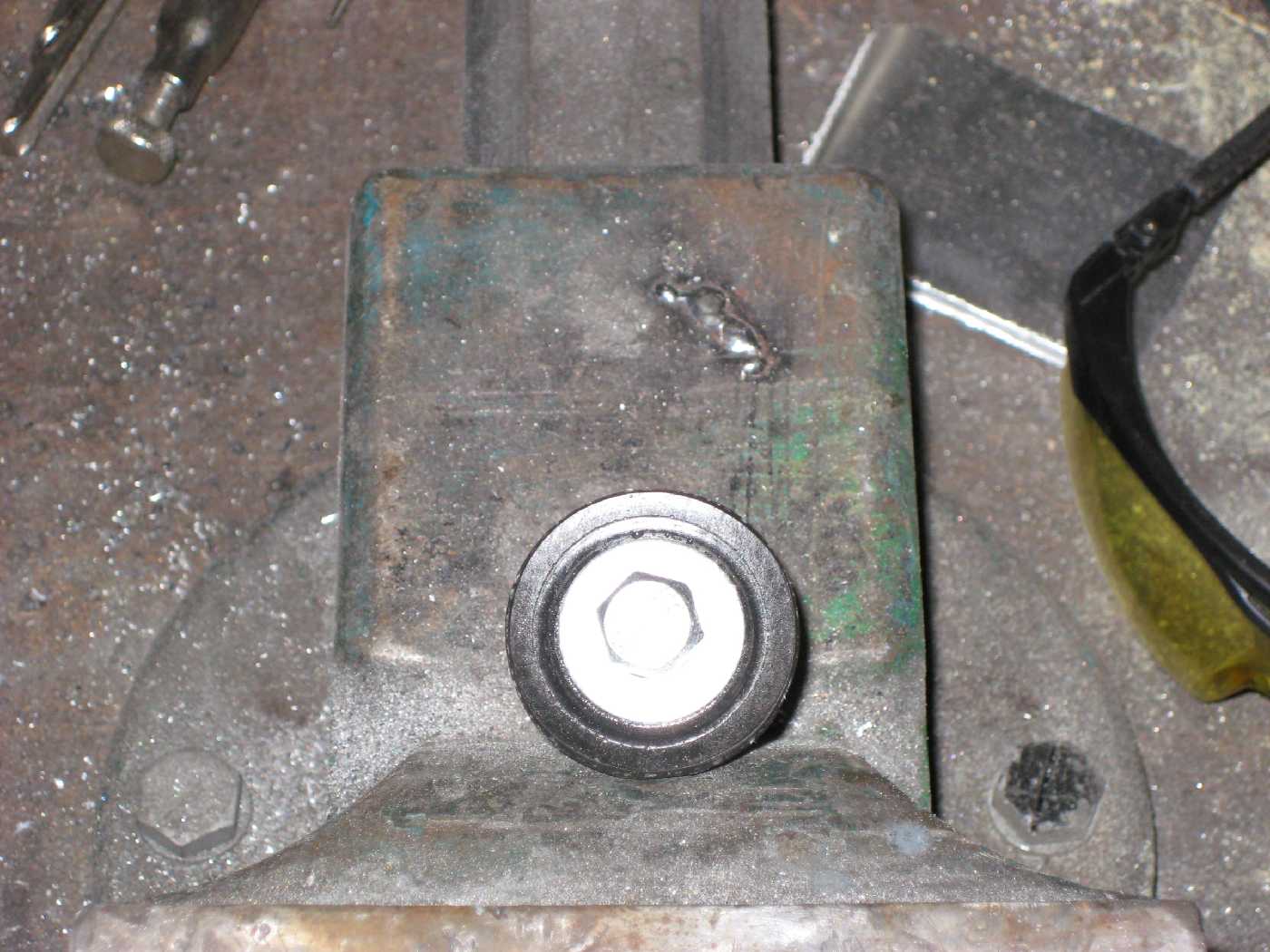

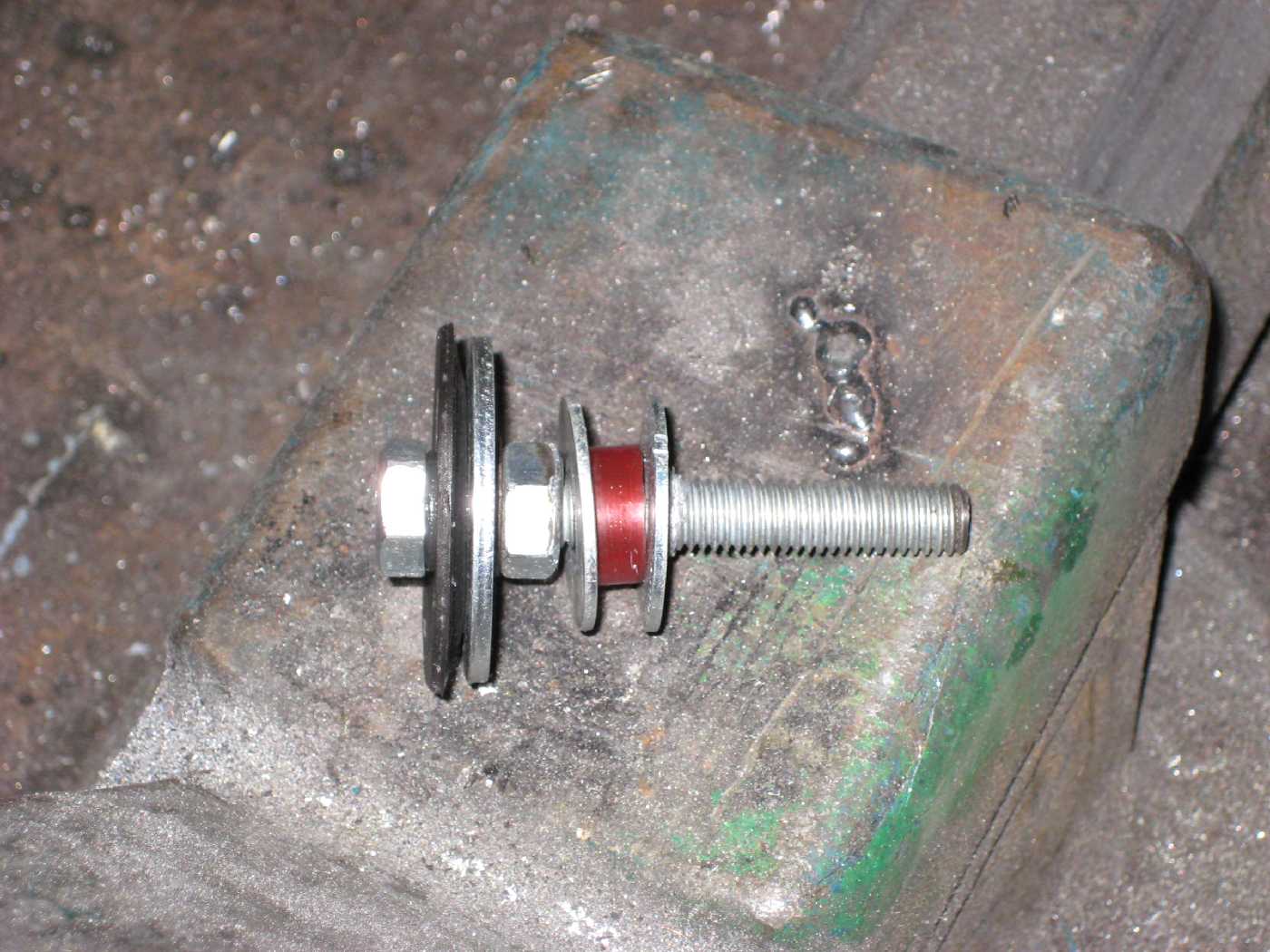

ok here is my piston..
hope it helps.
the reson i does not do much more on this thread is that it almost died out.
front
front
piston from the side.
this is how the piston is when open.
the piston and the &amp;quot;pilot&amp;quot; assembly. you make a connection at the end of your TEE or chamber to put this part. depends on how you build your cannon.
the piston and the &quot;pilot&quot; assembly. you make a connection at the end of your TEE or chamber to put this part. depends on how you build your cannon.
