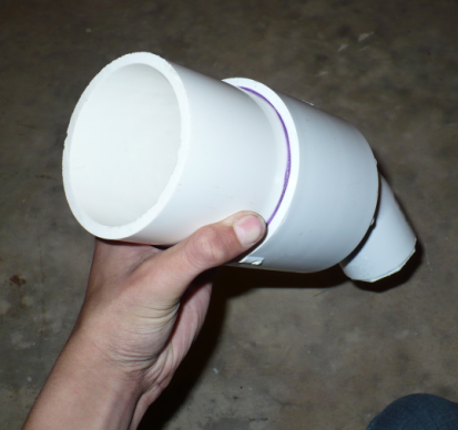

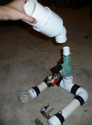

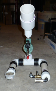

I decided to make a pneumatic paintball mine actuated by a sprinkler valve. It works fairly simple; There is an air tank made from 1.5" pvc pipe (that doubles as the base/legs and also has pressure gauge, male quick connect nipple and quick connector for multiple fill methods), a 3/4" modified sprinkler valve (actuated by a safety pop-off valve), and the large bore 3" short barrel for "bird shot".
The barrel can be easily taken off/put back on and is set at a 45* angle to hit mid body/head at about 5-7 feet away. Closer and it hits mid body/knees.
How it works:
You simply fill up the air tank to the desired pressure (which can be anything up to 220 psi, I have to get a new pressure gauge btw) and load the paintballs. Then you tie a string around the end of the safety pop-off valve and tie the other end to a grounded object about 7-10 feet away, crossing a commonly used path. And it's set! When the wire is tripped, that pulls on the valve, actuating the sprinkler valve, allowing air to escape and shoot the paintballs at the victim. Muahahahaha... :twisted:

front view of the monster at floor height.
Close-up of fill valves and beat up pressure gauge (don't worry, that pressure gauge will be gone by tomorrow!

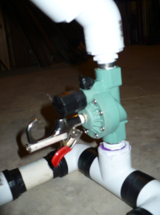

Close-up of the Sprinkler valve.  I will get some epoxy tomorrow and get rid of that fricken solenoid, ran out a couple days ago.  And I gotta get myself that damn pop-off valve, those things are so hard to find at hardware stores, I was thinking about stealing one off a air compressor at home depot, lol jk.  The blowgun was just to test the system out cause I couldn't wait lol.
See how the barrel comes off?...
The Detachable Barrel:<br />3&amp;quot; diameter<br />7&amp;quot; length<br />Max Paintball storage: 45-50<br />Performance : :D
3&quot; diameter
7&quot; length
Performance : :D

Just to point out though, The sprinkle valve won't handle 220 psi without the diagphram (sp?) ripping or risking the body of the valve breaking. 150 psi is a good pressure and 200 psi I would say should be max, and thats with some major modifications.
That aside, I like the pop off idea and the whole set up in general.
