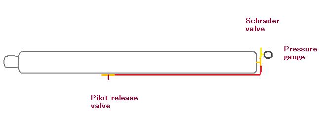

Here is a rough diagram of my plan.
inonickname
Posts: 2606
Sat Feb 07, 2009 9:25 am
That will work fine. The schrader shouldn't trigger it. The shorter the length of hose is before the pilot valve, the better. Also, blowguns work better than ballvalves in this context.
