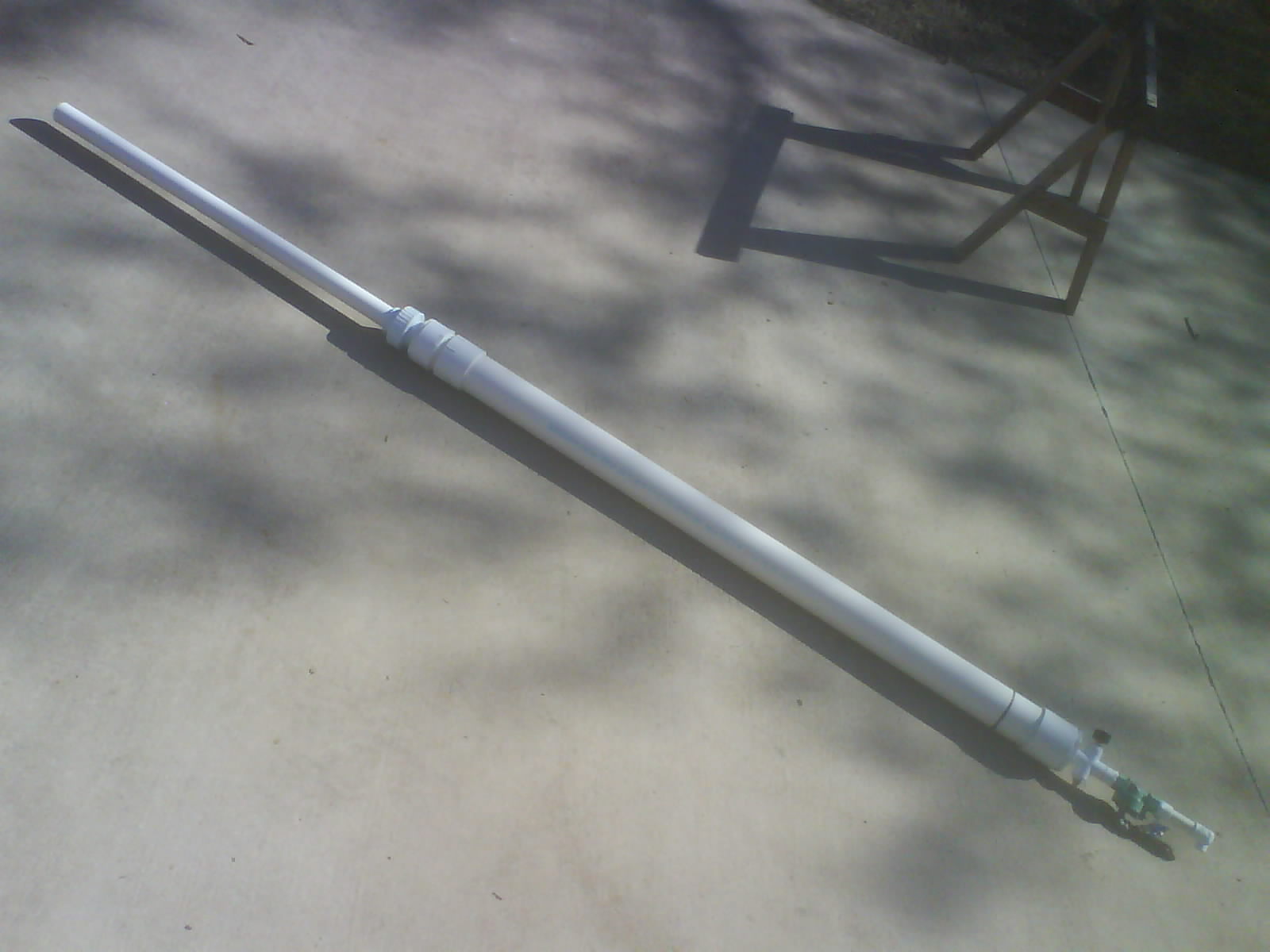

Hi guys this is my first post on spudfiles. I have been looking at this website for a while now and finally got to post something. This is the the bigger one of the two cannons i built. It is a basic coax and the first piston gun i have built. I haven't searched much yet but i haven't found another one this big any where on the website.
Specs:
chamber- 4" by 6'
barrel- 2" by 5' (9 feet with extension)
piston- 3" cap with washer on top
pilot- modified 1" sprinkler valve
operating pressure- between 50 and 70 psi usually
length- 8' (12' with extended barrel)
The barrel disconnects at the two inch union at the front of the chamber.

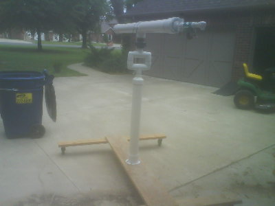

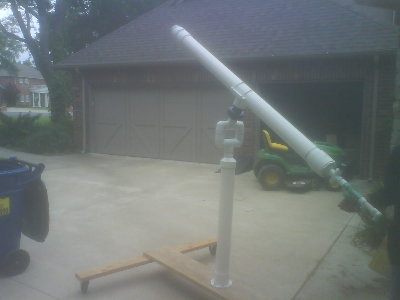

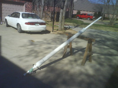

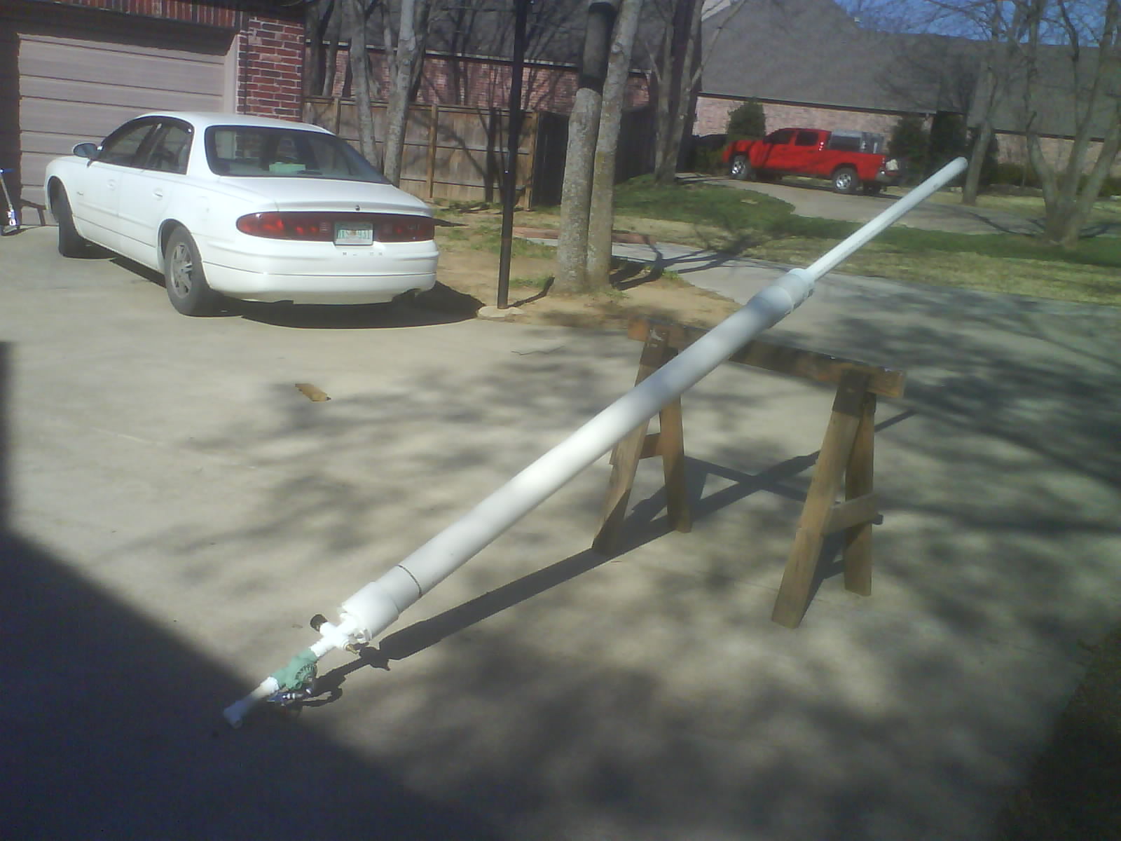

Edit: I finally got pics of the stand up. I know the size in kinda over kill but i don't want it to fall over. It has a full range of motion so i can shoot straight up if i want to. The stand comes apart so it's easier to store. both pics are without the extended barrel.

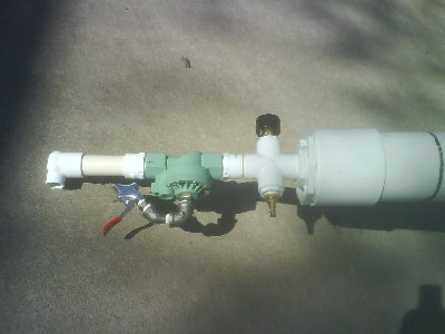

Pilot valve, air in, and pressure gauge
Stood up on saw horse to shoot
Full view with extended barrel
at an angle
at an angle
aimed horizontally
aimed horizontally

Mind explaining how the barrel is only 5' long, when the chamber is 6' long? Your pictures clearly show otherwise, with the barrel being 3-4ft longer than the chamber.
You do realize that you can push your ammo all the way back down the inside pipe, right up to the piston, right?
I would hate to think that you had been shooting with deadspace 1-2x the volume of your barrel...

having the hose still connected really doesn't bother me
the sealing face is a 2" union connected to the barrel and the piston has a big washer on it
the barrel inside the chamber is five feet long, with the extention it's nine feet long

Pretty unique way of making a sealing face there. What's better, it should seal extremely well, depending on how well you attached the washer to the piston. Even better than that, it decreases the opening speed of the piston by bringing the diameter of it and the sealing face closer together. Only thing I would worry about is how much clearance there is between the edge of the union and the inside of the chamber, but I'm sure it's not enough to harm flow too much.
