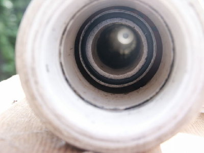

Mouse musket breech with the o ring.
Close fit works well.  Piston in the new home.

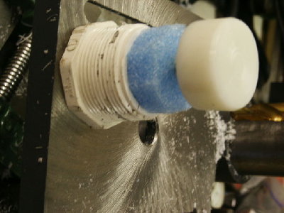

Breech parts with piston, bumper, and pipe plug.

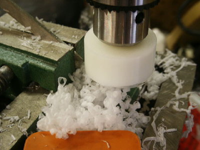

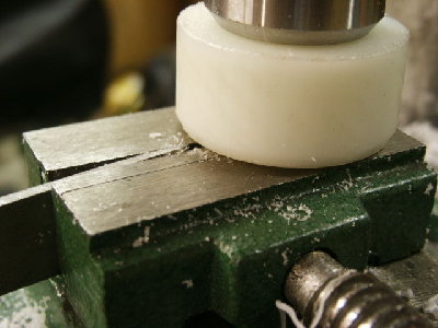

Cutting the piston face true and smooth.
Turning the piston with a drill press

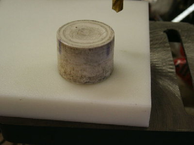

HDPE can most often use the same tools.
HDPE often comes disguised as a cutting board. :D
Sheet of HDPE  7/8ths inch thick.  The old original PVC pipe cap piston is sitting on it.
