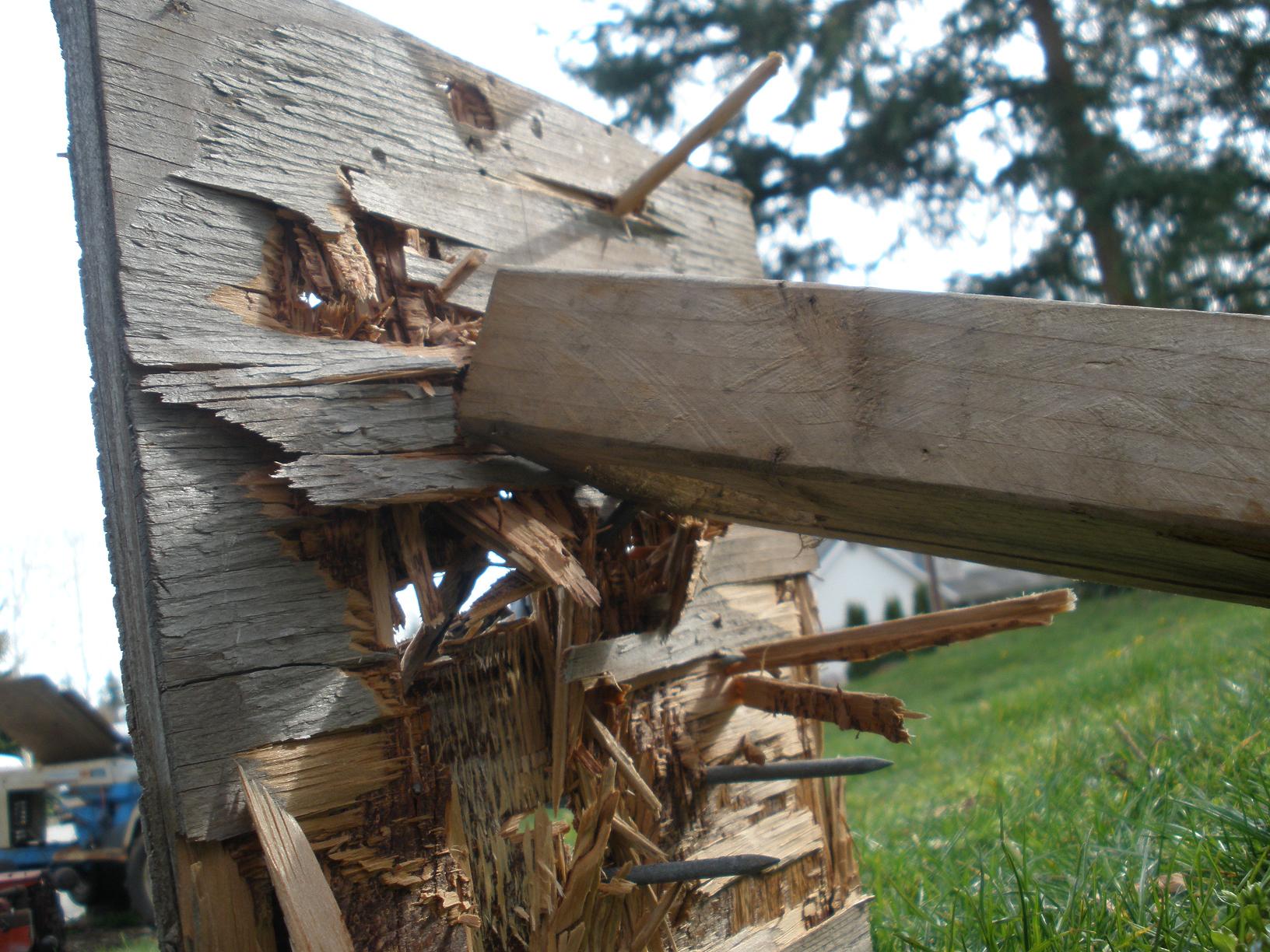

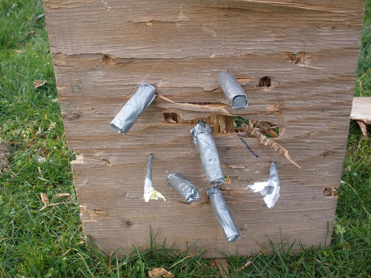

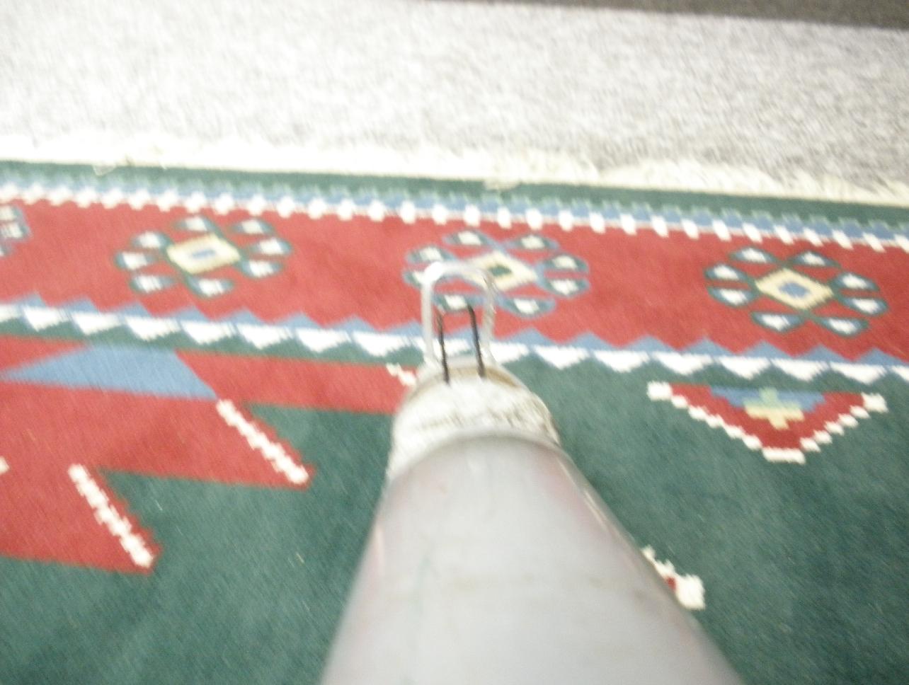

One day i wanted to make a cannon that was a total upgrade from the rest of my cannons. so i made an inline knowing that that would be the most powerful design choice. This cannon is great! it can stick a nail dart an inch into a health tree And explode an apple against a tree at only 20psi.The cannon is over 5ft tall with my 2" barrel. I have a 1/2" bolt action barrel, a 1.5" barrel, a 1inch thin wall barrel, and a 3/4" barrel. It has one problem though... the sprinkler valve leaks. It is leaking between the two plastic parts of the valve and out of the barrel of the gun. if anyone knows how i could fix it or something let me know.

no, its not sch80 its just this conduit kind of stuff i found in my shop.Do you think the leak could be somthing to do with the connection between the plastic and the blowgun? all i use was tefflon and a spade bit. no tapping at all.tghhs wrote:Awesome well done.

Since that is the same type of sprinkler valve I use... One part that could be leaking... It you take the top off then look on the inside of the top piece. There will be a small white spigot type thing that sticks into the bottom assembly. It also has an o ring around it. This should be covered in glue from the top but sometimes the glue doesn't get inside this. this can cause leaking from the chamber, through the equalization hole of the diaphragm, then out the barrel through the origional pilot hole.
To fix it you can put some super glue or something into the small hole from the bottom side.
Even if this isn't the problem, it won't mess anything up if you try it.
