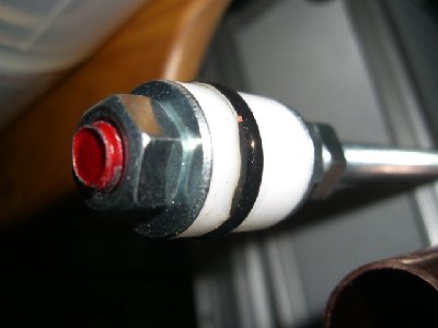

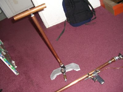

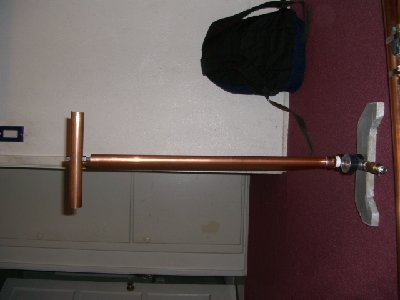

Finally got around to making a pump

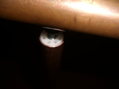

Machined the piston head and shaft stablizer from nylon

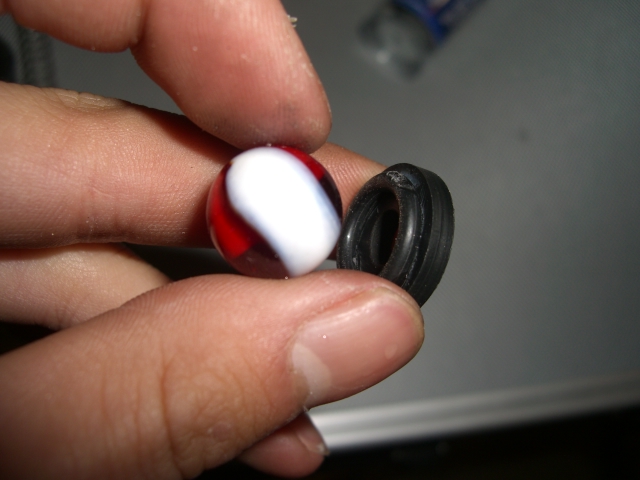

check valve is a marble sealing a against a washer/rubber washer and a spring
tube is 3/4 copper m
sand made from wood painted silver
handle 1'' copper

Nicely made, you failed to mention what pressures you're getting though ;)

Nice indeed. Does it work properly, does everything seal?
Beware of the checkvalve, if it leaks your pump will become a ram.

but you have a big dead volume between the O ring and the check valve so you will get to the point you compress the air in the cylinder and cant pass he cant pass the check valve

Nice job, what size washers did you use.

Ive gotten it up to 400 psi for now :) washers idk just foudn em hehe
