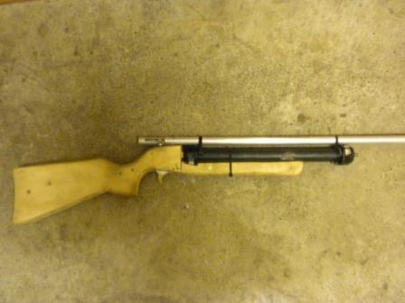

This is my first gun posting, so all comments will be greatly appreciated!!
The whole project revolved around making a hammer valve small cal. Plinker, with a home made 'T' valve. But in the process of designing I got side tracked and decided to make a single shot brass ‘T’ bolt action :lol:

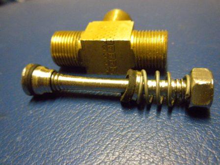

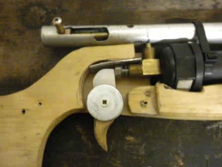

The valve is the same setup as see around here before for use as a hammer valve with filed down bolt, nut and O-ring. The only difference is instead of using a hammer for repeater style is im just using it to dump all the air at once with the trigger. The trigger is (at the moment) just a piece of ply cut to shape which pushes directly onto the bolt of the ‘T’.
The Barrel is my favorite part and in my new project, I will be doing the same although I hope to have it looking more professional. It also separates from the valve really easily while keeping a good seal so this give’s the opportunity of barrel swaps, as everything is built in to the 1 tube/barrel (the only thing is you can only go so far cuz of valve size ) but i was thinking you could probably up scale to ¾ etc?? or will the valve be to heavy ? The actual barrel is 6mm brass tube set center inside a 20mm ally outer barrel. im using steel bearings as ammo :) @ 100psi.

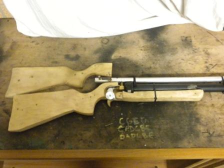

The stock is 4 x pieces of 3 core ply sheets screwed together and cut to shape, I originally did this just for testing so I had some type of stock, but have come to really like the idea as it is fully serviceable by just removing the top layer (3 screws). In my next project I think im going to do the same but use a hard wood instead??
I’ve only had this going a couple days but It has been really accurate over 10 - 12m without even having sights, so im thinking of making a nice set of iron sights instead of using the scope?
My only 1 problem with this at the moment is im finding it hard to keep a perfect seal. It only leaks ever so slightly, although it is enough to bug me... And I have seen these working at high pressures before so anyone who has played around with these valves, any pointers would be terrific !!
Anyway I will update this real soon as I get some more done, please let me know if you have any questions or comments hope you’s enjoy !!!

Triger setup
Triger setup
toy 058.jpg (22.17 KiB) Viewed 9832 times
Side panel removed to service internals
toy 067.jpg (23.53 KiB) Viewed 9832 times
Brass ' T' Valve and Stem
toy 031.jpg (31.11 KiB) Viewed 9832 times
Taa Daa.... The forestock is shocking but works a treat
toy 050.jpg (23.11 KiB) Viewed 9832 times

I've Started my new Stock which is similar to this one but haven't cut anything for the internals yet as i would like to change the valve..
I don't think it is very efficient, great for dumping, but i don’t think I would be efficient enough for a hammer valve & the button is a little hard to push which gives the trigger a real spongy feeling :roll:
So i was thinking of changing the valve so it has a smaller diameter stem and head (hoping this will bring the weight down some) maybe even casting a traditional hammer valve out of Reinforced epoxy ?? (JSR :lol: ) so any advice on that would be most appreciated!!

I quite like the idea of that trigger setup, but i have to ask, will pulling the trigger slow affect its effectivness?? And how stiff is the trigger?
P.s. Sry for any spelling errors ad missing/extra chars... I am on my phone:p
maverik94
Posts: 558
Fri Feb 26, 2010 4:55 pm
I would assume so, the other advantage of a hammer valve over this design (besides multiple shots) is that you get fairly consistent shots, which is very important if you need accuracy. I believe the answer to your question is yes, the faster you pull the trigger, the more powerful the shot.
He already answered that.
...DAMMIT!!! you've inspired me!! :D :D :D Now I'm considering making a very similar one from spare parts. I should have most it not all the parts i need for a basic project like this. The thing I love with this design is that it is so effing simple, and yet it is still practical and somewhat powerful. I wanna build this before I build my secret project... :wink:
Try using a piece of tire inner-tube for the seal instead of an o-ring (that's what you're using right now right?). I have used inner tube for 400 psi and it works great! I just have a huge piece of it from my dad's 1950s truck that I can use. I just keep it a little lubricated with some petroleum jelly to keep a perfect seal. I left the air in there (at 200 psi) for an hour and none had leaked out, so it seems to work for me! Also, you might wanna consider staining and varnishing that stock for a nicer look. Great job so far! Good luck, and I look forward to seeing your future projects! Btw, did you lathe the valve stem? It looks like you may have done that with a powerdrill? (Nothing wrong with that, just wondering)

chinnerz wrote: have to ask, will pulling the trigger slow affect its effectivness?? And how stiff is the trigger?
Yea pulling the trigger slowly does really affect the effectivness and power which is a little bit of a same when your trying to target shoot and be accurate but after a while you get use to it (fine for shooting cans and such :lol: ), and yes it is hard but i've found i tighten the spring it seems to fire better ??? i know stop looking at me like that lol :shock: i think cuz you don;t have so far to push the valve , if that makes any sence ???

I've mounted a scope and played with the valve and started to clean it up , have decided now to keep it as it is but finish it and make it look good , i also started a blow forward bolt for this body which i have tested and am now just waiting for my plastic to arrive (to0 make the final version), so i'll get some pic's up when i can ..

Wed Mar 03, 2010 12:34 am
it wouldn't be difficult to improve that.... you just need something that works like a poppet valve. Poppet valves are too some extent like QEVs... once you open them a little bit the pressure does the rest of the job for you
