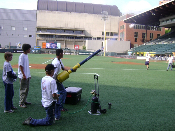

An alternative to a dive tank is a high pressure Nitrogen tank with a regulator. The school that built a QDV competition shirt cannon uses one as most sports arenas won't permit extension cords on the floor for the shirt cannon compressor.
Below is a photo of their set-up. The regulator is set to 100-150 PSI for quick fills, but they only fill to about 35 PSI using a gauge, as that is all that is needed.

The competition rules for the above had a 100 PSI limit. With the restriction, we won the competition. With no restriction, higher pressure and a smaller chamber makes sense. Even with the 100 PSI limit, we would have done fine with a chamber 1/4 that size. We were able to reach our target of the back row of the 300 section on only 35 PSI.
At 100 PSI my small chamber launcher with a 1 inch valve tosses shirts 200 feet.
