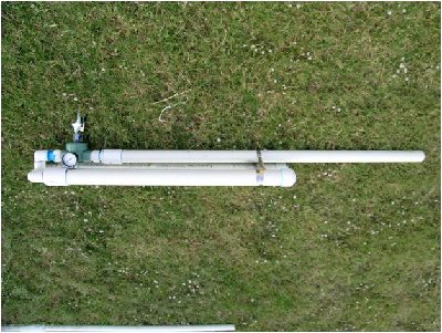

I made this one a few years ago, just never got around to posting it. (my first pneumatic)
Over and Under design
Chamber - 2 2"x36" inch chambers
Valve - modified solenoid Valve
Trigger - blowgun with ball valve safety
Fill valve - shrader valve
Barrel - 1.5"x51"
C:B ~ 1.8:1
bit overkill but that was kind of the point, more fun that way. I don't really plan to paint it. Its meant to be a beast, not a pretty beast. Ill paint one of my better ones.

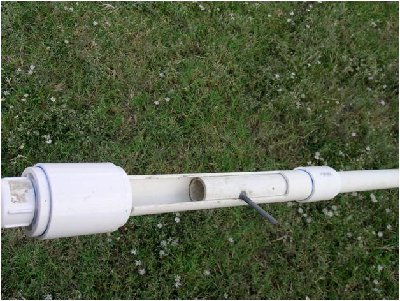

something im particularly proud of, my breach loader.

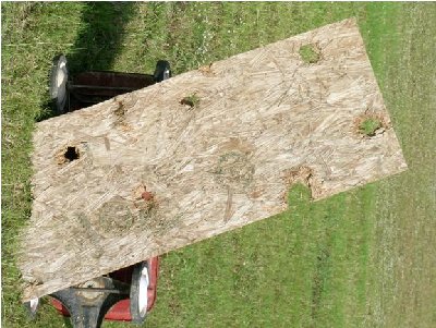

damage from 15 yards after a few shots

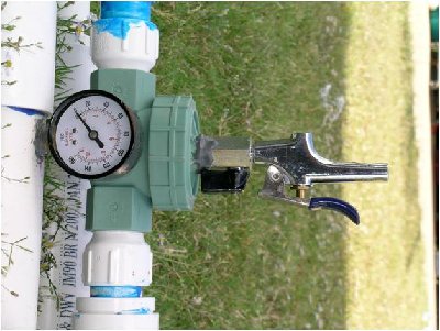

valve and gauge

full cannon

Looks like all your parts are pressure rated
But you could use a valve with a little more flow. The single sprinkler is constricting flow a little, duel sprinklers will get the job done but I would reccomend looking into piston valves or burst disks.

Very nice cannon. That sprinkler valve would allow a good amount of performance from a 1-1/2" barrel, but it sounds as though the diaphragm is bouncing, signaling that something is wrong with the valve or the method in which you modified it.
Usually that sound (honking) occurs when there is too little pilot flow. Being that others have used the same type of blowgun you are using, I would say the problem would be air leaking into the pilot at a rate too fast to allow efficient actuation. Was there a guide rod in the valve originally?

oh ya the guide rod is all still there. and you are also correct on the cause of the honking noise, i just hold down the blowgun till all the air blows out. If i just tapped the trigger, it re-seals.

Maybe fill the eq hole and make another one but smaller, or pilot off a bigger valve.
Or even mod your blowgun for more flow (look in How-To section)

Your pneumatic is a clean, well designed unit as well. I like the no non-sense blowgun and gage setup on the sprinkler valve. Have you found the honk problem yet...sort of took away from the shot.

The honking issue is just simply that i choose to hold down the blowgun till the chamber is empty. If I just pressed and released the blowgun, it would re-pressurize the pilot volume and there would be no honking.

yes but the honking means that you are not getting the full power out of the valve. tap in a 1/4" ball valve and i bet it will go away and give you more power.
