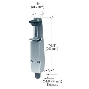

also, what do you think of 1417A1 on McMaster-Carr as a hammer. I got the idea from a how to for a zip gun on youtube
EDIT:
The QEV would certainly allow better performance, but you're also losing some air through the pilot so it might still even out in terms of shot count.
Looks like it could work, assuming the spring is strong enough, and it's fitted in such a way that it doesn't continue to press on the valve when in the "fired" position.

The spring in those is certainly strong enough.
We sell them at work.
But unfortunately they do push all the way, so the valve will remain open.
