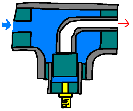

Wed Nov 09, 2011 12:36 am
Lockednloaded wrote:I was considering putting a smaller diameter elbow inside of a larger tee much like BtB did for his unregged BBMG
This is how I picture it using standard parts and epoxy, lots of turbulence though *cough*diagram fixed*cough*
Last edited by jackssmirkingrevenge on Wed Nov 09, 2011 1:19 am, edited 1 time in total.
warhead052
Posts: 1769
Wed Nov 09, 2011 1:12 am
Other way jack, your arrows are going the wrong way. It wont work like that... Unless I am missing something.
Right you are, as it was would have made a great pop-off valve ;)
Fixed.
Wed Nov 09, 2011 2:18 am

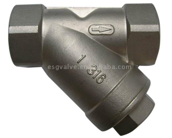

facepalm.... you can get metal valves lthat look like that
if you don't have them check valves have the same internals

POLAND_SPUD wrote:Image

jsr wrote:untitled.png
That's what I was thinking, except with a rubber diaphragm with a metal washer for support. Does anyone know a good way to drill through solid rubber?
As for the check valves, I'd prefer to not order anything for this project, but thanks for the ideas
