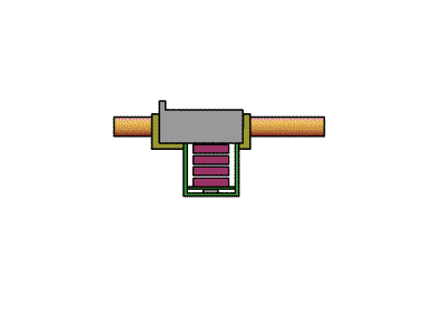

Oh thanks, is this applicable in Australia? Or would you not know? I had a look in my local hardware store and they have a lot of copper piping, and fittings. I ended up buying the 12.7mm copper pipe, so would the next size up be 19.05mm with around a 13mm interior diameter?
...and perhaps a loading system like this :)
The Diagram is pretty self explanatory... :twisted:
Tehehehe
Tehehehe
Sat Jan 07, 2012 9:32 am
Truck wrote:...and perhaps a loading system like this :)
Add a cam system and you can make it pump action ;)
