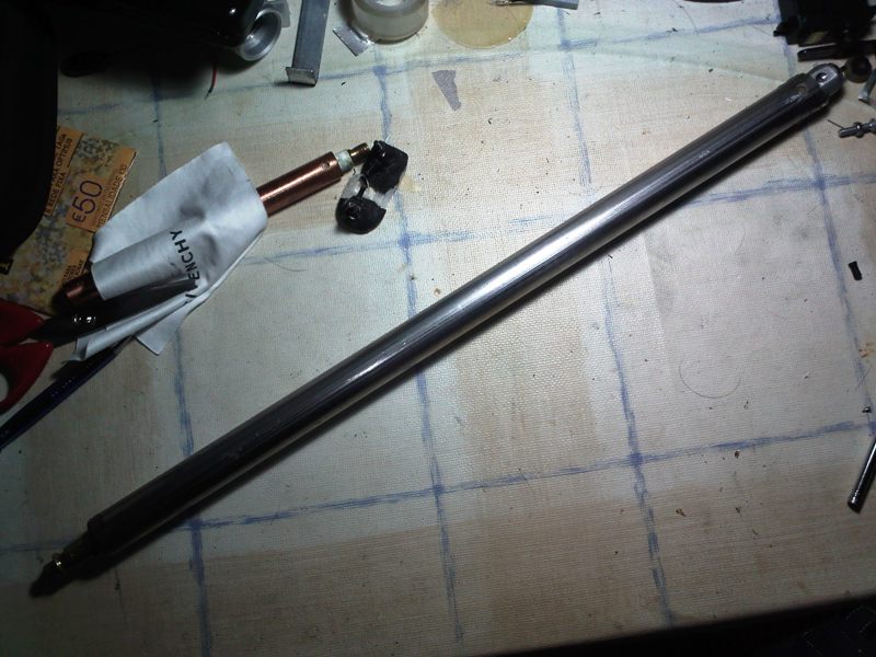

I have started my new pcp project. (BTW Gun Freak hope that´s ok to you
I had did some big modifications to the blowgun valve, replacing the original rubber seal by a harder seal material that are used in co2 pin valves. Now it deals with high pressure with on problem. I have charged ti to 500 psi, left it for 5h, no leaks at all 8) then I checked the valve internals, no damage
The quick connection is a industrial type, build for high pressure, I add a internal one way valve so I don´t need a ball valve, making it light and better looking.
It gives me at least 60 shots
It actually hurts a lot if you put your finger near the out put and hammer it, when fully charged
