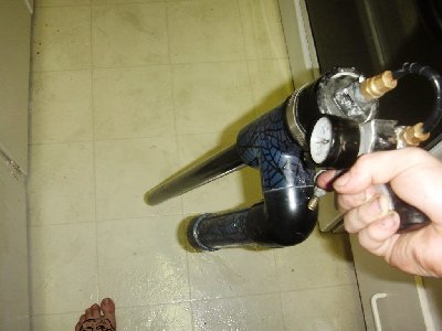

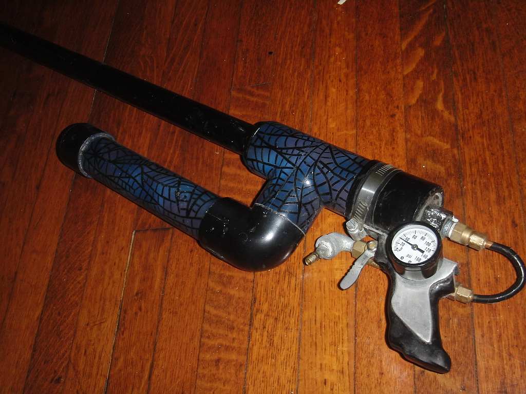

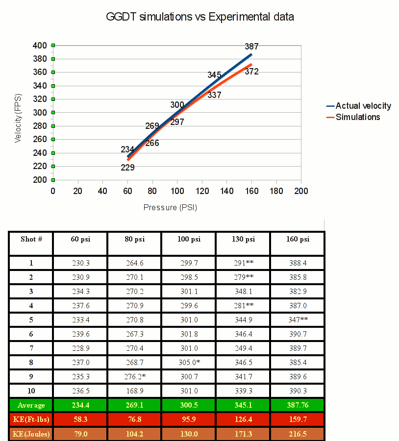

I wanted a general use and test platform pneumatic so I made this. I have some experimental data at the end which I compared to GGDT predictions as best I could. The results lined up quite well and I believe most of inaccuracies were the result of my human-error in pressurizing the gun accurately and consistently.
Video link (with obligatory death metal, of course)
Note for D_hall:
I tried using your valve flow coefficient calculator, but it got through the first couple data sets then got stuck in an infinite loop for some reason.
Also kudos for making this thing so damn accurate. Tweaking the numbers sightly can get near perfect data alignment, but I believe the ones I used are the most representative of my gun.
Specs on the gun:
Chamber: 30 cubic inch
Barrel: 1.05" x 23.75"
Valve: 1.05" porting piston valve
Piston travel: about 1"
Piston mass: 98 grams
Pilot: 1/4" ballvalve
Maximum muzzle energy: ~160 Ft-lbs (217 J) with a 31 gram projectile, 160 psi
Projectile weight was 31 grams.<br /><br />*=Accidental overpressure; was not included in average<br />**= Erroneous chronograph reading; also was not included<br /><br />Note the extreme consistency in the 100psi Column. I think this is because the '100psi' mark on my pump was bolded and very easy to see. I believe with a more accurate gauge I could get this gun to vary as little as 1 FPS between shots, no joke.

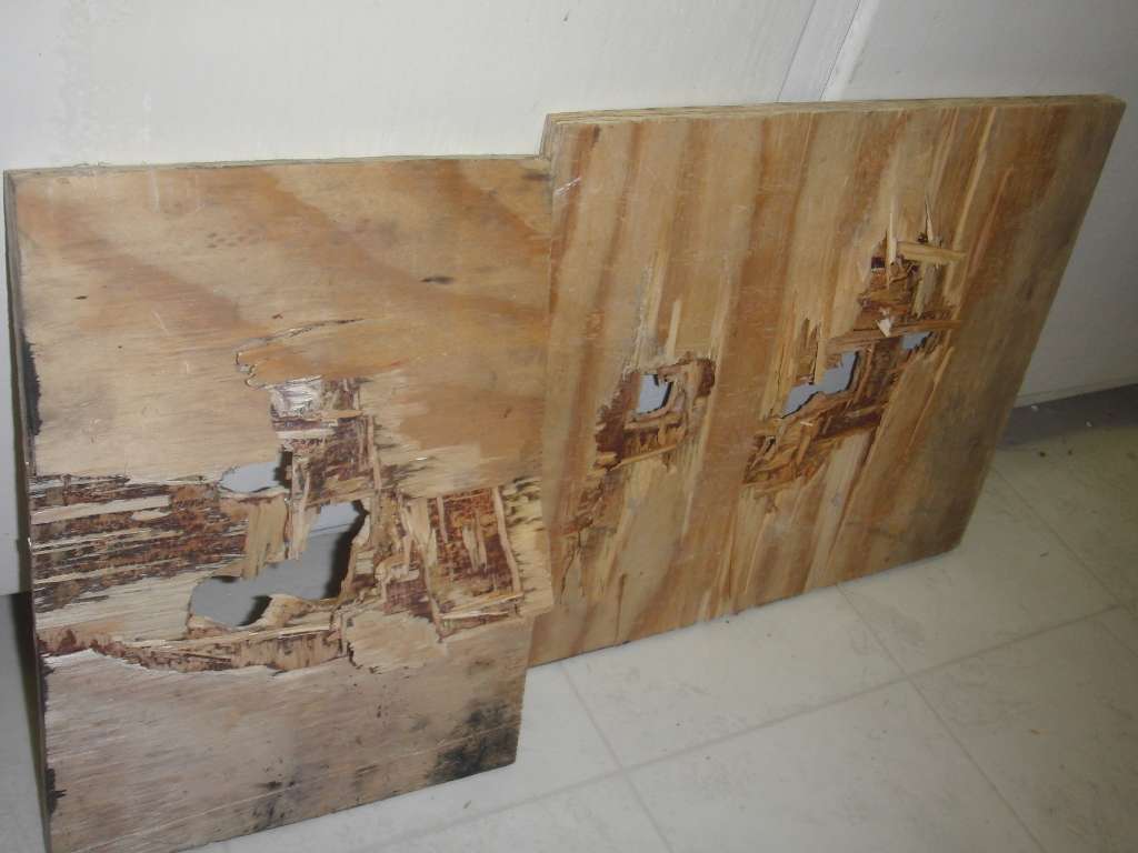

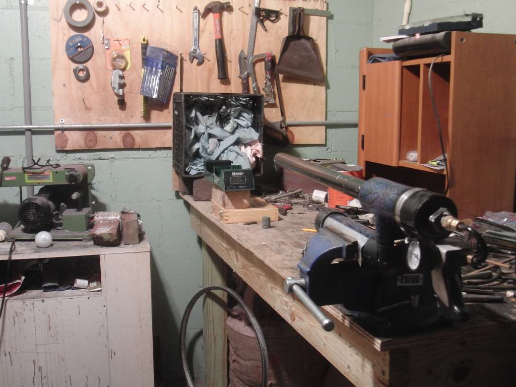

Test bed. I added a plywood shield later to help stop the muzzle blast.

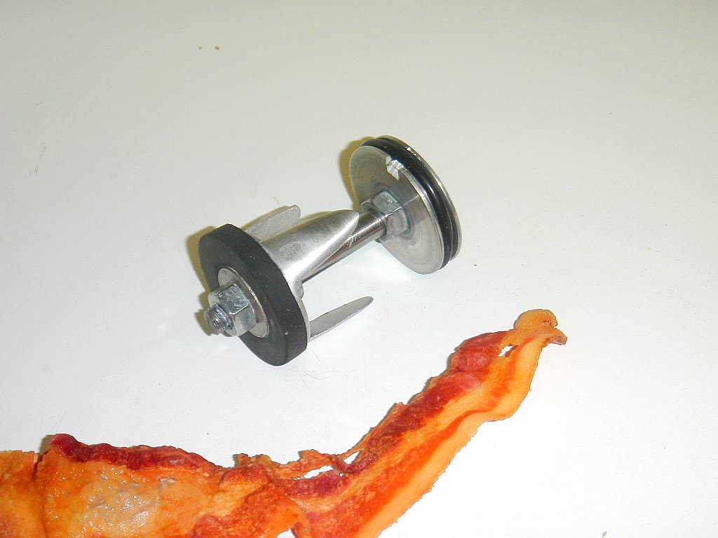

Stainless and aluminum, floating oring. This was made with a hand drill before I got my drill press. And it was very intimidating sanding it down by hand while it was whirling away at 2000rpm.

Very nice! Looks like a nice chunk of fun! Anything in particular you will be testing with it? Oh and the bacon was a nice touch, but you should have gone with tactical bacon
Wed Mar 21, 2012 12:51 am
Bacon!
I like the piston support.

Very good test! I love to see a good GGDTvsReality test.

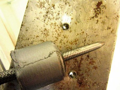

Little penetration test for sh*ts n' giggles.
15 gram chunk of round file vs. 0.130" (3.3mm) mild steel. Technically made it through, but the 'exit' hole is only about 1/16" wide
The ducttape sabot weighed an additional 15 grams and separated on impact, so this was only the equivalent of 75 ft-lbs (~100) joules of kinetic energy against the target.
entry holes are 0.2&amp;quot; wide
