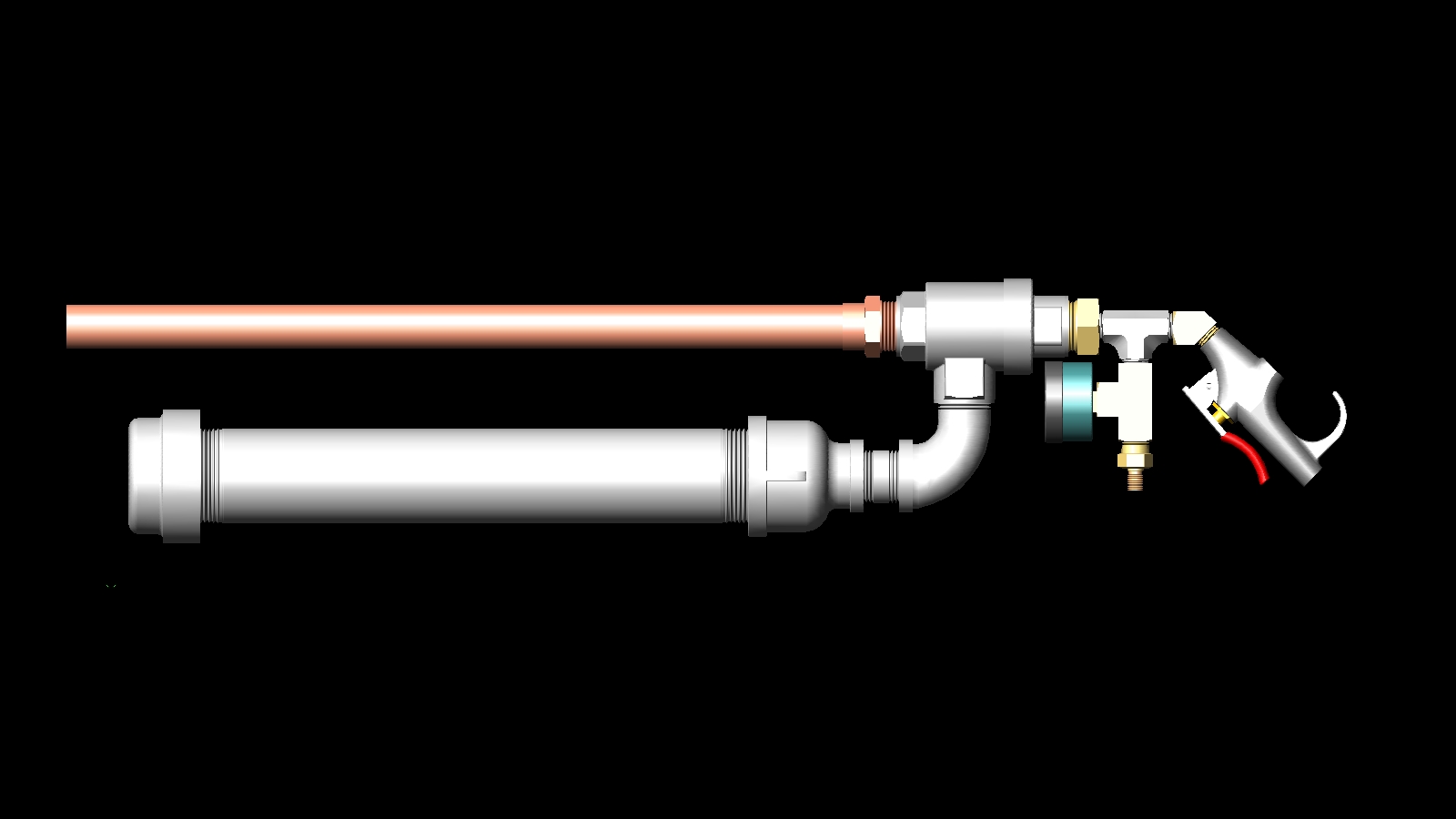

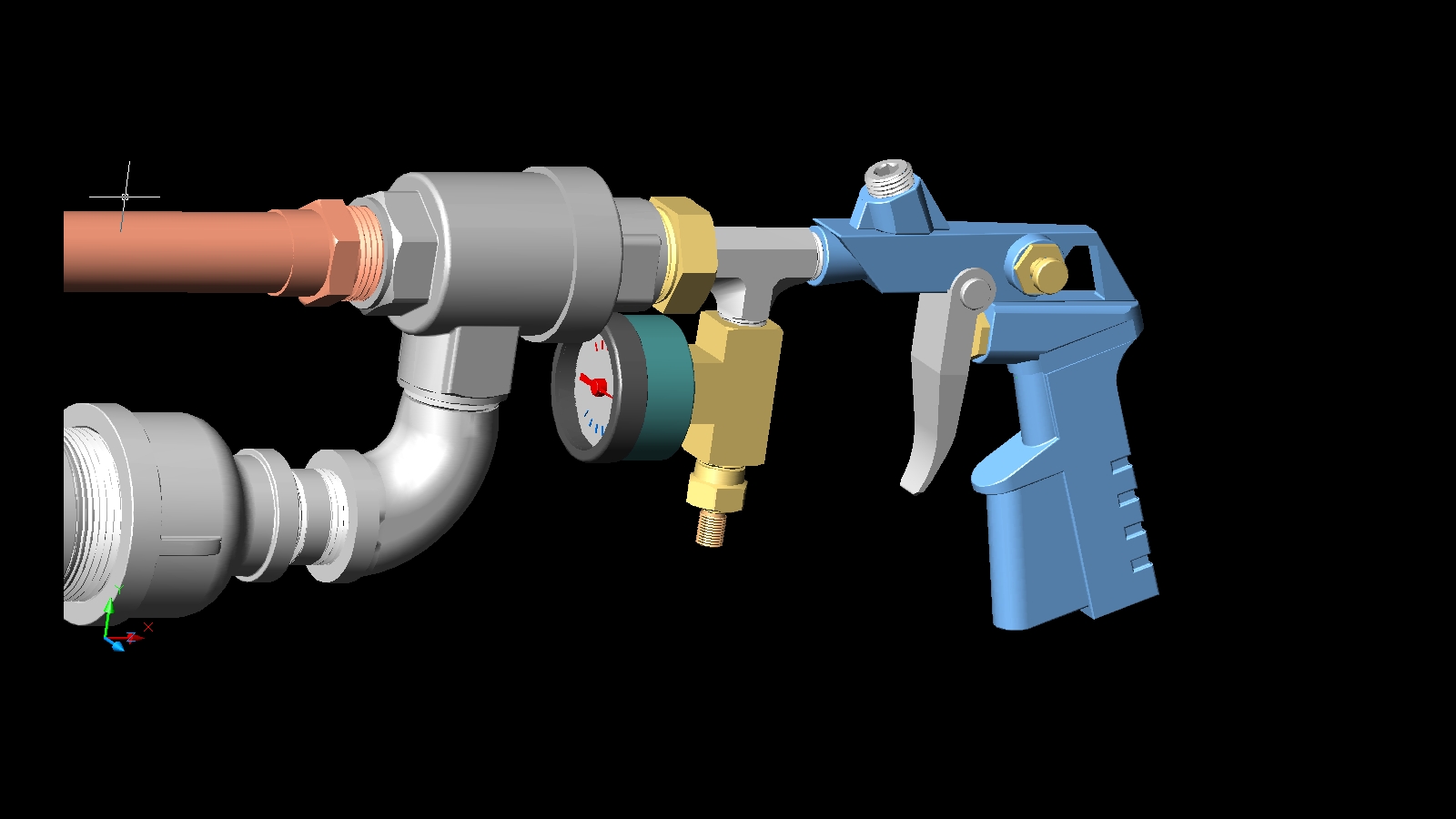

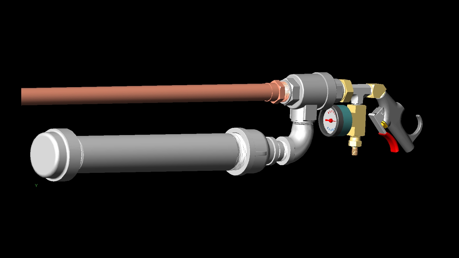

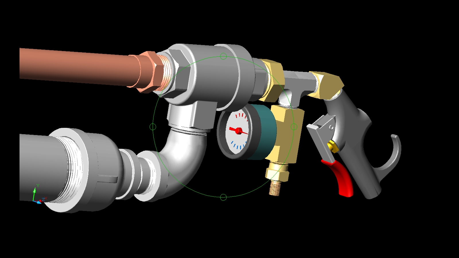

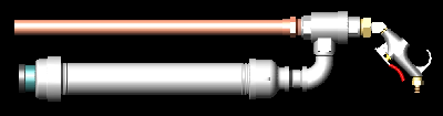

So does this design work? Thanks!
(Don't judge my horrible handwriting/drawing skills
1
Quick-Exhaust Air Valve 1/2" Inlet, 1/2" Cylinder/Outlet, 3/4" Exhaust
2
Low-Pressure Aluminum Threaded Pipe Fitting 1/2 Pipe Size, Coupling
3
Standard-Wall Aluminum Pipe 1/2 Pipe Size X 18" Length, Threaded
4
Low-Pressure Aluminum Threaded Pipe Fitting 1/2 Pipe Size, Tee
5
(2x) Standard-Wall Aluminum Threaded Pipe Nipple 1/2 Pipe Size X 1-1/2" Length
6
Low-Pressure Aluminum Threaded Pipe Fitting 1/2 Male X 1/8 Fem Pipe Size, Hex Reducing Bushing
7
(2x) Standard-Wall Aluminum Threaded Pipe Nipple 1/4 Pipe Size X 1-1/2" Length
8
Shock-Resistant Gauge Plastic Case, 1-1/2" Dial, 1/8 NPT Ctr Back, 160 PSI
9
Low-Pressure Aluminum Threaded Pipe Fitting 1 X 1/2 Pipe Size, Female Reducing Coupling
10
Low-Pressure Aluminum Threaded Pipe Fitting 1 Pipe Size, Cap
11
High Volume Lever-Handle Blowgun 150 Max PSI, 1/4" NPT Female Air Inlet
12
Standard-Wall Aluminum Threaded Pipe Nipple 1 Pipe Size X 8" Length
13
Brass Air Fill Valve Straight, 1/4 NPT, 1-3/8" Overall Length
14
Low-Pressure Aluminum Threaded Pipe Fitting 3/4 Male X 1/4 Fem Pipe Size, Hex Reducing Bushing
15
Low-Pressure Aluminum Threaded Pipe Fitting 1/4 Pipe Size, Tee
