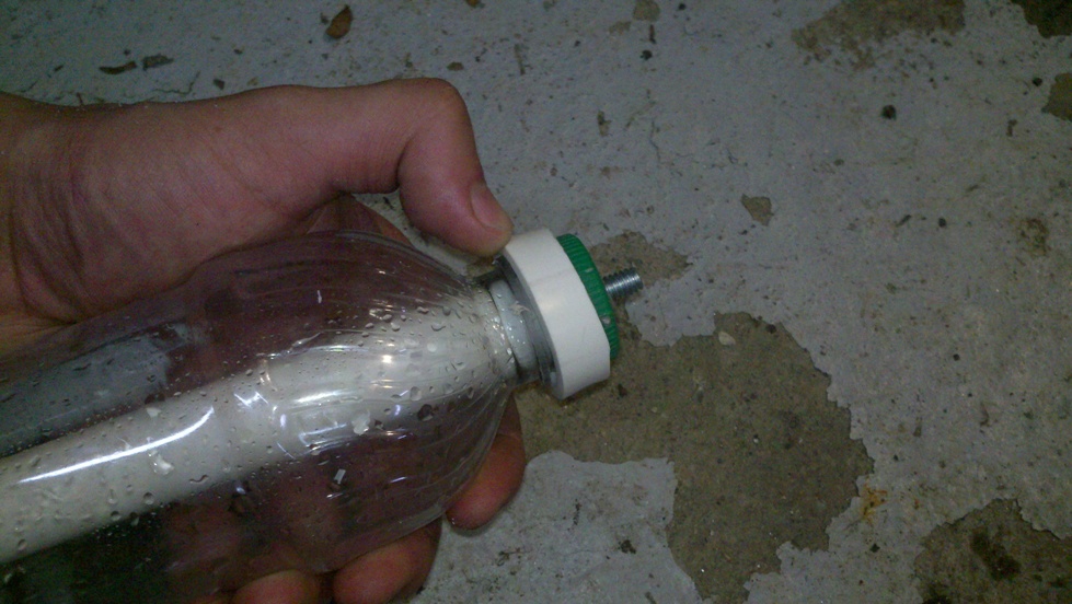

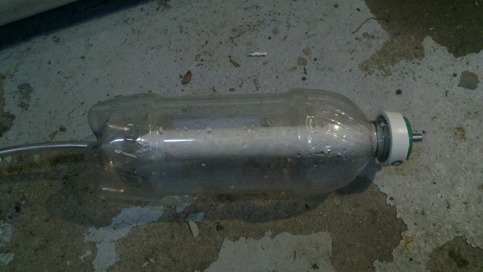

gentlemen it's been a several years since I've last posted about a project in the works, but I was browsing this thread and some of the talk about special valveless rod projectile launchers reminded me of an old soda bottle rocket launch system I created when I was a TA for a shop class in high school. the launch system was just a schrader valve in a soda bottle cap with the walls slashed so the the cap would be held together with a pipe sleeve and a system to push the cap out of the sleeve so it would release the bottle. It occurred to me that this same system could act as the air seal and the the detent for a launcher similar to the grappling hook launcher kydavies is planing
so I created this prototype (pictures below)
I forgot to take pictures before the first test shot and as you can see the projectile likes to break itself on impact, luckily enough of it was intact for a second launch that I got on video
TL:DR WATCH THIS VIDEO OF ME EXPLAINING IT
so plus side is that this pretty much costs nothing to make and is only the size of a bottle, but the projectile has a short lifespan and takes time to make, I plan on using this for launching a grappling hook and maybe a spear head
the launcher is triggered by sliding the sleeve forward

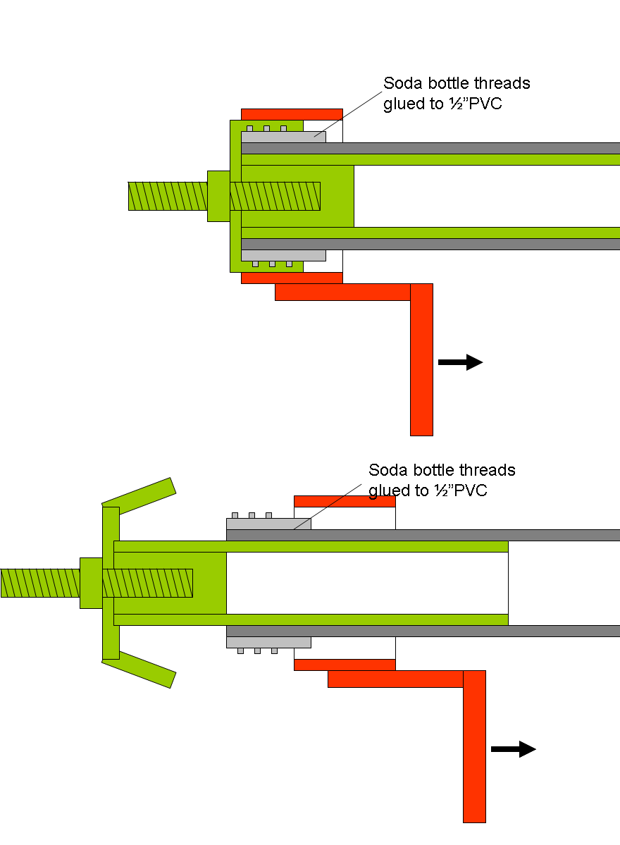

also @PVCArsenal would you consider this a neater disconnect system

iknowmy3tables wrote:also @PVCArsenal would you consider this a neater disconnect system
I say just use commercial quick connects ;) available forpeanuts on eBay.
a standard quick connect can't do the trick, the cross sectional surface area is too small and it can't accommodate the necessary rod that acts as an inside-out barrel
