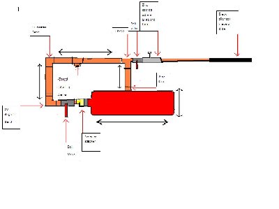

Constructive criticism is fine. I used paint
Ball valves are acceptable for shooting dards or what ever. I said the ball valves are a problem but use a QEV will change the current configuration of the gun radically.PaperNinja wrote:Few things
Ball valves are TERRIBLY slowly-opening valves. You'll get much better performance using a better valve like a QEV. With a ball valve you'll find that unless the projectile is heavy or has significant barrel friction, it's not really gonna go anywhere.
Also, so many bends of pipe slow down the flow of air, decreasing performance.
Silencers don't really have an effect on pneumatics.
I don't know what you are planning to charge your tank to, but if you want any significant number of shots per fill, AND consistent shots, you'll need a regulator. (Unless that's what you meant by pressure adapter, which I think it may have been)
For all that chamber volume, you might want a longer barrel. Lastly I don't understand what the grip-like thing is doing there. (The one next to the firing ball valve.)
Other than that looks good!
Ninja'd by wyz
You beat me to itwyz2285 wrote:The most important thing: Suppressor
works with pneumatics. (JSR will be here soon if he saw your statement)

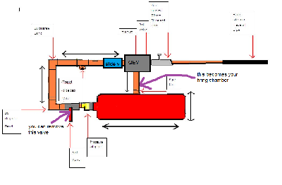

Not necessary. As I have said, you can build it the way you wanted. The use of a QEV will improve the power but if you are not familiar with them you may get problems. A ball valve's simplicity will certainly insure your gun will fire every time you open it. Also depending where you live, finding a QEV and slide valve maybe tricky so I'd say build it first then think about improvement and find out the power increase yourselfjoshywin wrote: So I basically need to change the whole gun layout?
If he builds it in the QEV/slide valve configuration the bend will be irrelevant.mattyzip77 wrote:Why not make it a strait gun rather than a over under??? You will lose alot of power with that big u shaped bend, or just make the distance less in the u.
