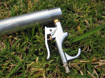

Didn't get a lot done today. Tapped the rear plug and blowgun for the schrader valve.
Ordered some M4x6mm bolts for securing in the end cap & barrel cap.

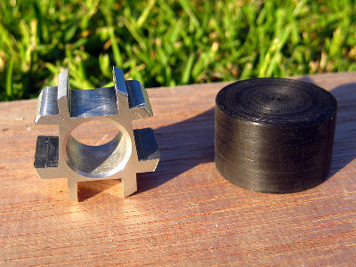

Thu Nov 29, 2012 2:57 am
Ok so I kinda got a bit sidetracked these last few weeks with exams and other boring stuff hence the delay.
Taking your advice I tracked down some nylon rod for the piston.
Today I quickly knocked up the barrel support/spacer and the piston.
Sure they may not look fantastic but they're out of site so I don't mind.
I need a bit more practice with the turning of the nylon but it's a nice fit and I'm sure more than functional.
Rubber face has just been epoxied to the piston and I should have it assembled for it's first test tomorrow.

Thu Nov 29, 2012 7:50 am
Looks like you're moving in too fast with the parting/facing. When it's burning the material like that it will also tend to make a squealing sound. Use a load of coolant if you can.
What RPM did you run that at?

Thu Nov 29, 2012 11:41 am
You dont need coolant with nylon/plasitcs. But use HSS tool, and it needs to be very sharp ! Nylon is too soft for carbide insert tools.

Thu Nov 29, 2012 12:20 pm
It definitely helps with PP, PVC, ABS, PVDF, even POM but mainly to stop it from going everywhere.
Interestingly, the place I worked at used carbide tips all the time but that could also be because a lot of the harder plastics such as PPS were glass or graphite filled.

Thu Nov 29, 2012 12:37 pm
matti wrote:You dont need coolant with nylon/plasitcs. But use HSS tool, and it needs to be very sharp ! Nylon is too soft for carbide insert tools.
X2 Much better results with SHARP HSS on Nylon, Nylatron, Teflon or Delrin. Use an extra fine diamond file to clean up and polish the edge after grinding.

Thu Nov 29, 2012 8:55 pm
Nylon will wear well in the launcher. But it will still be quite a thump towards those small M4 screws holding the rear cap on. And yes, the softer the workpiece material...the sharper the tooling needs to be.
