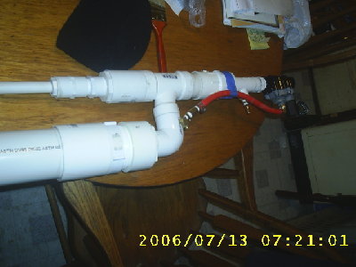

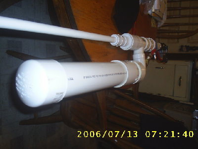

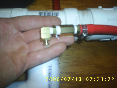

This was mostly constructed of spare parts left over from building my other two pneumatics. Its nothing amazing, but I like it nonetheless. Plenty of power, but this .5" barrel has to go. It has a 2" piston valve of the adjustable type that I was discussing yesterday in the pneumatic forum. The trigger is a homemade push button made from an elbow and the push button from a tire filler gun.
