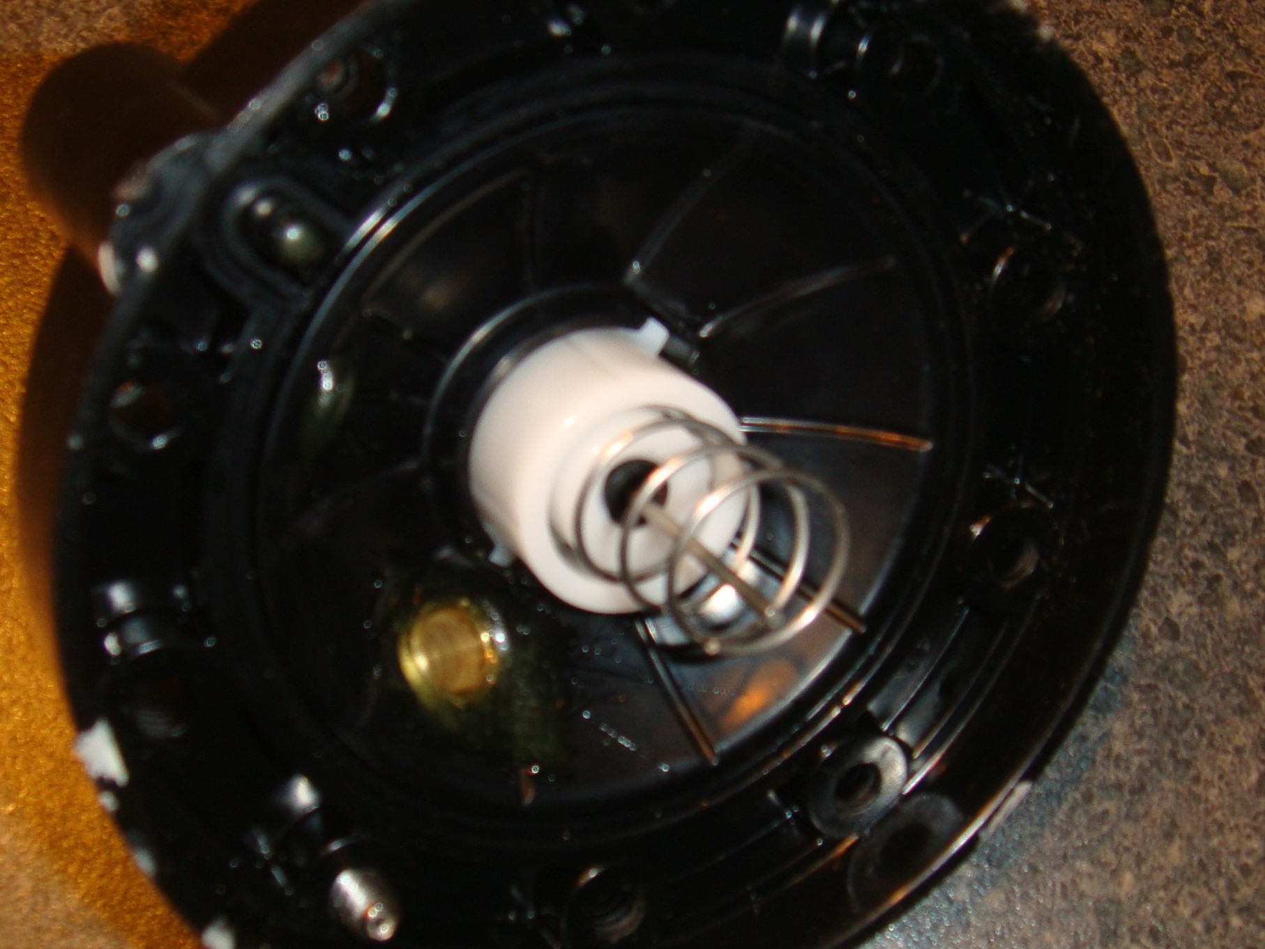

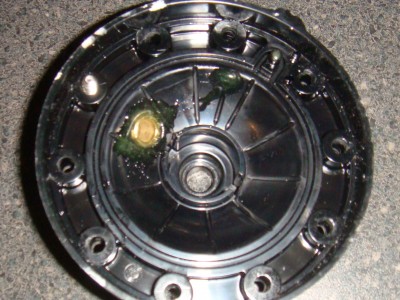

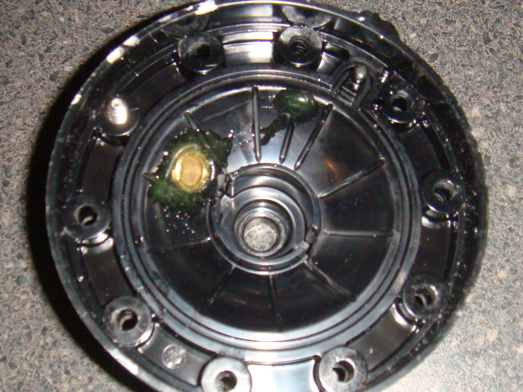

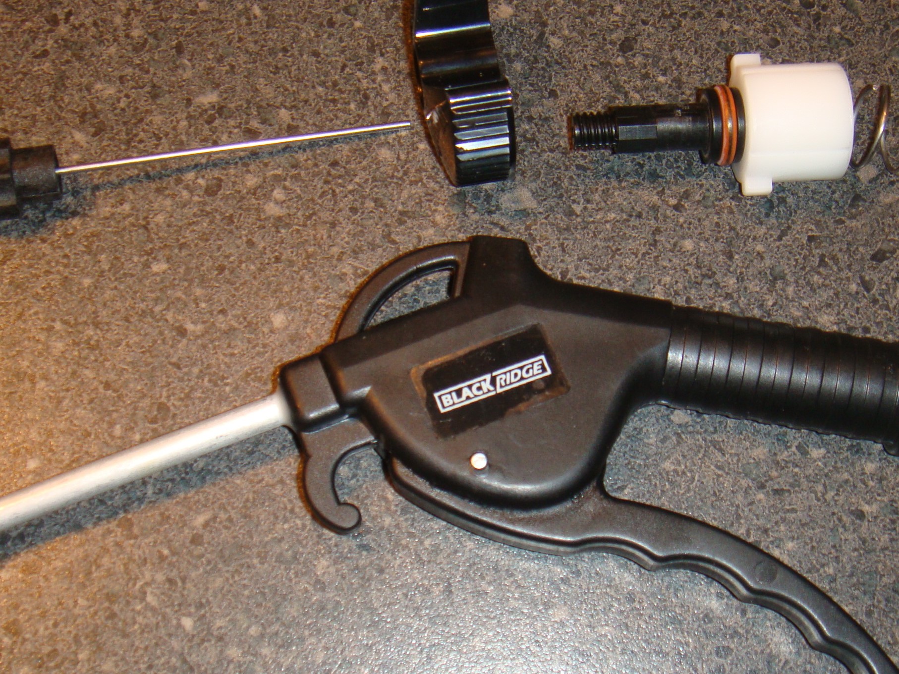

ok so I now have modded the sprinkler valve from the side (leaving guide rod ect in place),1/2 inch thread into the side of the valve,got a 10$ blow gun,just waiting for the epoxy to harden.
heres some modd pics

in the last picture the hole at 1 oclock should I have poxied that one?It joins up with a hole that runs to the exaust side of the bottom half of the valve.
- Posts: 125
- Joined: Tue Apr 01, 2014 12:53 pm
I would plug the little hole at 1 o clock, it will probably allow the valve to stay open longer.

What an amazing difference the blow gun has made.As soon as I pulled the trigger on the blow gun there was a hole in my plywood target (spud ammo).Took it to 70psi.Amazing power.
Thanks so much for your help.
