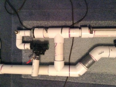

Anyhow, I've been making a golf ball cannon for a while with a 2" piston valve but it won't work. My piston sucks so I figured I'd rebuild that. I've got metal shop next year in high school so I wanted to machine one, but then I took a look at my cannon and thought my piston area might be too short. I now plan to rebuild the entire piston area and piston but before I do I really want to know wha sort of dimensions would actually work and work efficiently. I'd hate to get the lengths wrong again and have to rebuild it AGAIN so I would love some input on it. Thanks in advance!

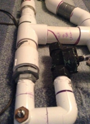

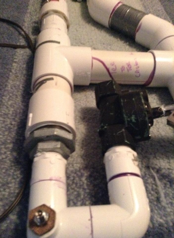

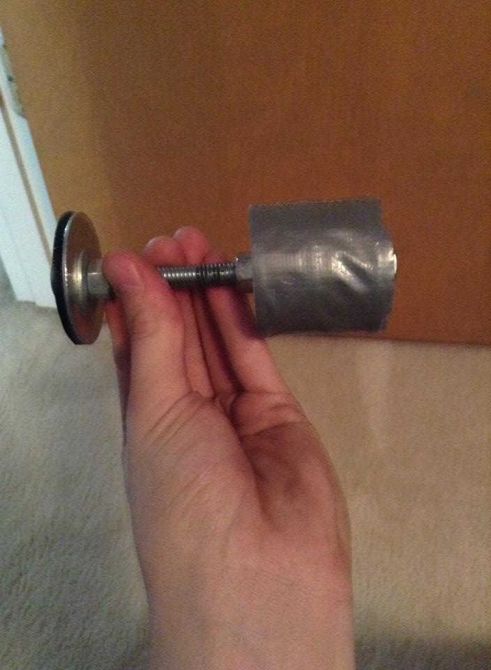

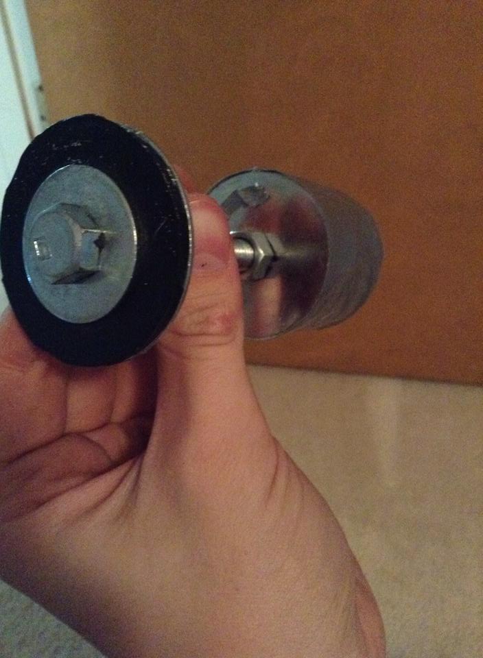

Piston-about 4 3/4''
2'' pipe the piston rides in-about 4 3/4'' (with current crappy back stop)
Space between sealing face and pipe-about 1''
