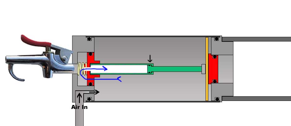

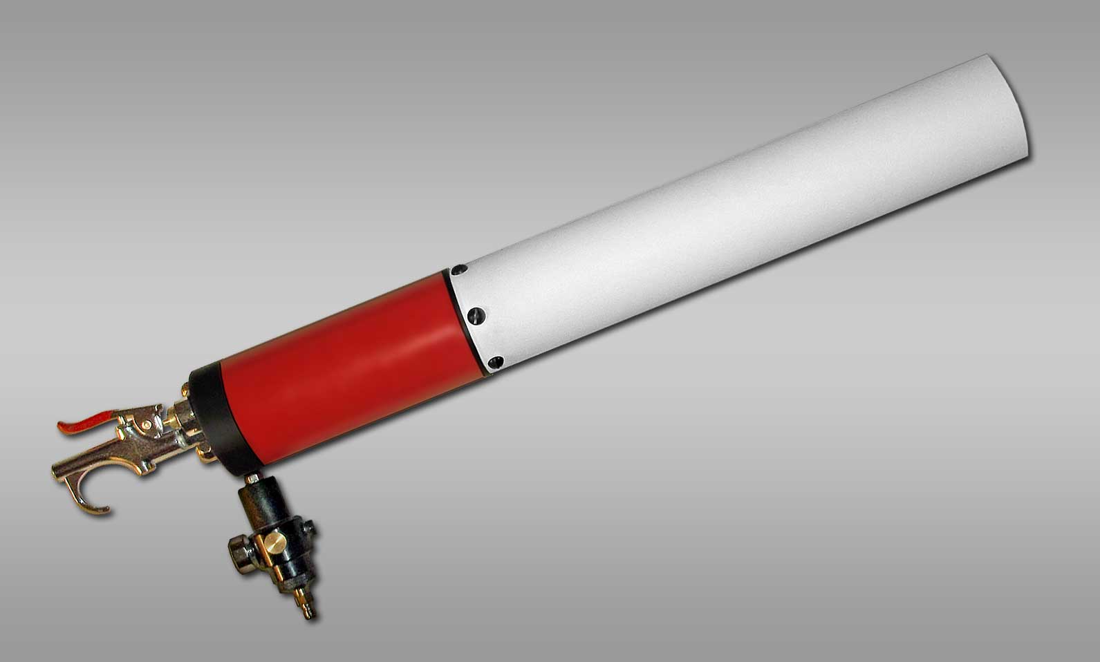

I finally finished the first stage design of my t-shirt launcher. It operates at up to 300 PSI with a 10:1 safety factor. Later I will add a homemade pilot valve, homemade regulator and homemade flow valve.
There were five basic requirements. It had to be safe, inexpensive, hand held, light-weight and, of course, powerful.

Wow that looks nice. Can tell a lot of time and effort when into the design to make sure it was safe and worked properly! Did you have any trouble sealing up the threaded rods? What regulator is that
Looks to be a handful

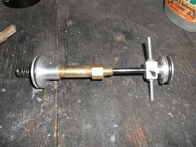

Nice work! It wasn't readily apparent how it was held together until I looked at the rear plug and saw the lock nuts.
Then of course I re-read the article and realized I missed that note...
A little note on the spacer which holds the piston centered in the large portion of the chamber, since the photo's resolution is a little low... is that aluminum (or a softer metal than steel)? I would be worried about scratching channels into the inside of the chamber.
Looks great though. I can really tell you spent your time designing this.
- grumpyoldman
- Posts: 106
- Joined: Tue Jan 31, 2012 8:04 pm
- Location: Texas
Good catch. The stabilizer was made from standard threaded rods. I'm going to change that to using eye bolts with the eye going over the holding rods.mark.f wrote: A little note on the spacer which holds the piston centered in the large portion of the chamber, since the photo's resolution is a little low... is that aluminum (or a softer metal than steel)? I would be worried about scratching channels into the inside of the chamber.

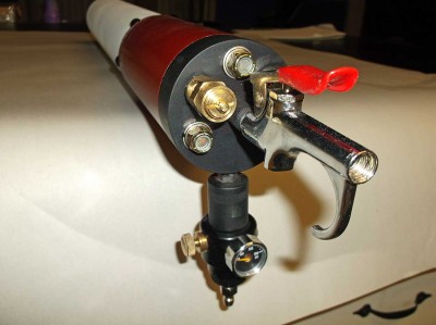

Palmers female stabilizer might help streamline the look a little...
http://co2reg.com/index.php/regulators/ ... black.html
Can be had in lower pressure versions as well.

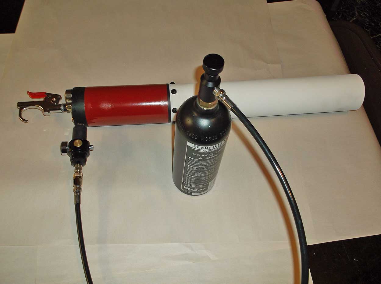

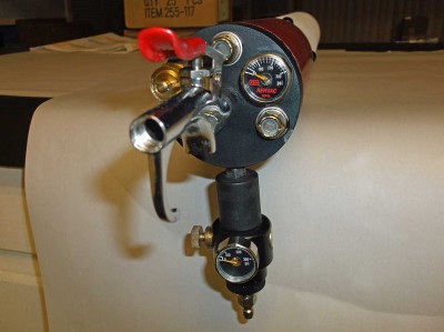

I must say I'm impressed! And it has been a while since I got impressed by a cannon here :p
Switch to eye bolts is a smart call otherwise I'm worried about the guide bolts scratch the chamber too.
Kinda weird to have the regulator on board instead of on the bottle but I guess that's no big deal.

Thanks, Gippeto. It means a lot getting recognized by my fellow spudders!
Thanks for the compliment. The reason the regulator is on board is because it leaks when screwed on the CO2 bottle. Cheap Chinese regulator. I'll be adding a homemade regulator later. I wanted to get the main valve working first.wyz2285 wrote: Kinda weird to have the regulator on board instead of on the bottle but I guess that's no big deal.

Very, very cool!
I love how you tucked away the safety valve and gauge!
Also, the endplugs and the rods are a nice touch.
Using the rods as guides for the piston is brilliant!
Any chance you'll put two elbows on the blowgun and add a front grip to shoot it minigun style?

Knowing your ability for efficiency and simplicity of design, I had a feeling you would appreciate using the holding rods as guide rods. A lot of my design was inspired by your work on counter balanced valves. The regulator and pilot valve I'm designing for my t-shirt launcher will be CBV's. It will be a few months before the launcher is completed. I probably showcased this too soon but I couldn't resist showing off the main valve.Brian the brain wrote:Using the rods as guides for the piston is brilliant!

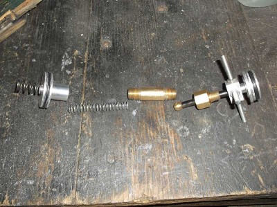

I'm not sure what the classification of the main valve would be. Would it be classified as a toolie type CBV using a pneumatic pilot?
“Disarm the people - that is the best and most effective way to enslave them.”
― James Madison
― James Madison

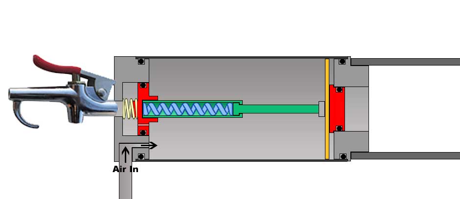

That's a great looking cannon!
I love the sleek inline design but i wonder if something like this would do as good a job of venting the pilot pressure and look cool on the back with all those dials? Or maybe a push button to launch setup?
http://valves.specialtymfg.com/product/ ... 1-8-fema-2?
Also random question but does it dry fire effectively? It looks like it would need a significant barrel back pressure to compress that spring in between the sealing faces and since the barrel itself wouldn't really provide any back pressure (being significantly larger than the piston it looks like it would just open partially without good pressure.
Could a system like this solve the problem by reducing opening pressure on the front part of the spool? (I think it is a kind of modified spool valve?)
This way when the pilot volume is vented the piston can move fully back without much impediment. I am probably way way wrong with this idea but it's just a thought.

As far as I can tell it's a 'regular" toolie piston valve.I'm not sure what the classification of the main valve would be. Would it be classified as a toolie type CBV using a pneumatic pilot?
The only real difference is you're using O-ring in stead of a flat rubber seal.

Thanks for the suggestions, Tep.Tep wrote: Also random question but does it dry fire effectively? It looks like it would need a significant barrel back pressure to compress that spring in between the sealing faces and since the barrel itself wouldn't really provide any back pressure (being significantly larger than the piston it looks like it would just open partially without good pressure.
It dry fires great. It doesn't need any back pressure for the piston to completely open. There's a lot of backward force still in action when the back piston suddenly stops. That force is then transferred to the front piston which forces it back. The spring is weak and doesn't need much force for it to compress.
