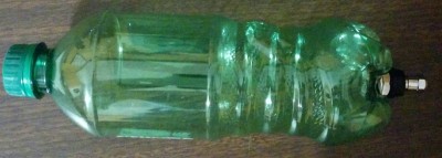

I finally found some Schrader valves, and I installed them into mountain dew bottles (they are a pretty good fit in 3" PVC and are made of a thicker plastic).
However, the burst disks are still not working. I tried an O-ring but it was too thick and would not let me screw the cap back on. I tried taping the aluminum foil, I tried glueing, I tried alternate burst disk materials, but nothing seems to work!
On top of these struggles I'm worrying whether it will even have the necessary force to leave the barrel, but perhaps adding some water into the bottle like a bottle rocket may help...

Thanks for the advice guys, I made a lot of progress this morning, but it's still not functioning properly.
I found out that the mountain dew bottle caps have a little extruding ring on the inside that prevents a gasket or O-ring from fitting inside. I simply opted to use coca-cola caps instead.
My sealing rubber is actually a rubber pad meant to go under furniture feet, but it's fits perfectly and seems to make a good seal if the burst disk is cut well.
Sadly, even though I've been able to pressurize the bottle, the disk refuses to burst. Instead the firing pin simply pops a hole in it and the pressure instantly leaks out with a "pssssss" noise. I'm pretty sure this is from low pressure, but every time I try to pump higher the disk explodes before I'm able to remove the pump.
Then again it could be because the air pressure has no mass to push on, so perhaps placing some water in the bottle is needed... :scratch:

Well, I've done some further tests and I'm nearly there, but something just doesn't add up.
I am using 4 layer thick aluminum foil and a cruddy electric car tire compressor.
At 60 psi the burst disk actually popped, but only slid up the barrel a few inches before sliding back down.
At 80 psi the burst disk sprung a minor leak, but I quickly dropped it into the mortar and it slid even further up the barrel!
This is both good and bad news. With a nice burst disk this could possibly fire at a very high pressure, but I don't think either the disk or bottle for the matter could handle the necessary pressures to even leave the barrel.
Perhaps this is due to the projectile being too heavy? Or perhaps the hole in the cap is too small for optimum flow? Or maybe it's time to fill it with a bit of water?
A lot of factors to test gentlemen. Stay tuned and please give me any feedback you may have!
