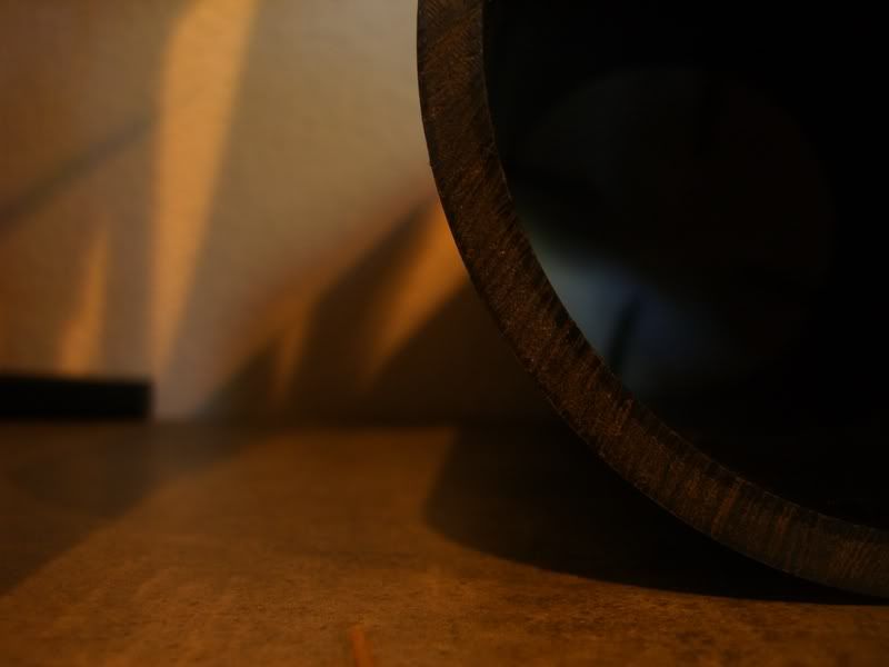

Spudblaster: Even though the pipe looks solid core that dosn't mean it is. Fine, you may have solid wall pipe. Many people have already stated that the only pipe they can find is cellular core. Your pipe dosn't say solid core on it anywhere does it?
Take a piece EXACTLY 1" long of 4" sch 40 ABS and weigh it. If it is cellular core it will weigh the same as my ABS cellular core. Otherwise it will weigh substantially more.
Here is a High-Def knofe cut of the wall.

Then I'd go back to my assumption that if it has no pressure rating, it is DWV only and therefore cellular.
And yes, SpudStuff, though I believe you, the picture is very dark and should be retaken. Try taking the picture in a bathroom by the sink. Seriously. The light and the mirror helps.

Yes I agree. The pressure rated stuff IS solid core. They had a small piece at my dad's work. It is for LP gas likes. Because the gas will destroy PVC and pit steep pipe. Dunno where that get it though.
The picture seems fine on my computer. Try ajusting the brightness on your screen.
Maby that means that the cellular core is DWV and the solid wall is pressure. Because they are both Sch 40 dimentions thay can be used together.
