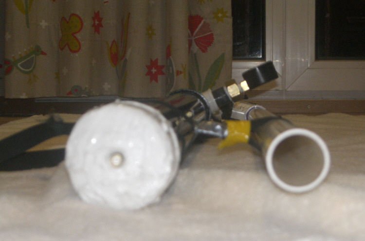

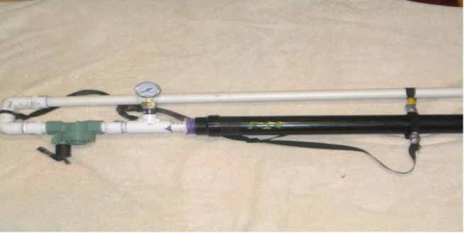

This is my first cannon, the F-14, a pneumatic. In the back of the cannon, I used treaded parts so I could easily modify the cannon later. I also discovered that if you don't put in the tire stem right and don't seal it well, it will come back to haunt you.
Here are the specs:
1" in-line Watermaster sprinkler valve
2" Chamber
1" barrel

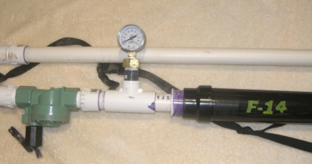

This is the valve setup and pressure gauge
The Cannon, in all her glory

Looks ok :)
I don't think its operational yet unless you're using a triggering method I don't know. The solenoid ain't wired up and its not modded.
Are you going to go with solenoid piloting then?
I'm not sure if its just me but the endcap on the chamber in the second picture is making me think of hot melt glue.... :wink:

As for ammo, I pretty much use anything I can find, which involves a lot of pinecones. I usually go up to about 80psi, but occasionally I go higher.
I agree, I need a paintjob, but it is not in ready supply here (I am currently in switzerland, in a small moutain town)
As for triggering, my electrical was being bizarre, so I'm using the manual until I can get more supplies. It seems to work just fine, but please tell me if that is actually destroying my cannon from the inside. :D

Is that a abs chamber?
noname
Posts: 2698
Location: Bay Area, CA
Thu Mar 15, 2007 7:55 pm
NEVER USE ABS IN PNEUMATICS! Do I have to say this every week? Especially because you cemented to PVC, which lowers the pressure rating even more. Cut the ABS chamber off, and replace it with PVC, or it will blow out eventually.

Umm noname wooldn't a abs chamber be safe because that would be the part most likely to blow on a cannon, and abs splits so if the chamber blew he wouldnt be hurt (maybe have sore ears from the air.)
mega_swordman
Posts: 526
Fri Mar 16, 2007 5:15 am
Once I hae proper supplies, I will fix the problems on the cannon. Thanks for pointing it out anyway noname.
spudthug
Posts: 936
Location: johnsonburg, Pa USA
Fri Mar 16, 2007 5:49 am
it is stupid to use abs...it is stupider to use abs and cement it to pvs...it is stupidest not to use pvs glue on abs!!!!!!!!read the dam back of the can!!!!!!it says in big freeking letters *WARNING: DO NOT APPLY THIS OR ANY KIND OF PVC OR CPVC GLUE TO ABS PIPING OR FITTINGS!!!!!*
