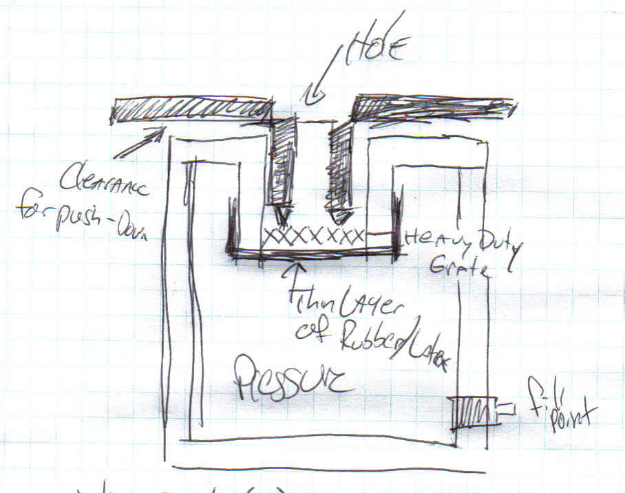

Here is the promised image of the mine:
The XXXX Layer is a heavy grate at the bottom of the chamber. The rubber or latex or whatever you find works best for the diaphragm will just be wrapped over the end and sealed. This setup will allow the "burst disc" style diaphragm only to rutpture when stepped on, as it would be penetrated by the punch pins on the sliding top plate. The load of flour or paint would go in the center hole. Obviously this is just a rough sketch, but it should help to illustrate my idea...

Have the diaphragm replaced by a solid disk and have it attached to the central trigger pipe.
The pressure inside keeps the disk pressed against the outer tube but when its pressed down by someones weight air can be released through holes in the inner pipe forcing out whatever.
A lot easier to build to cope with decent pressure.

Even with some kind of small helper spring to keep the unit shut while discharged, or under low pressure, that idea would also be a suitable build.
