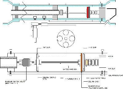

Tue Oct 02, 2007 11:42 am
This is the internal layout of the bazoka. I tried 5 times to add it to the album and it would not go through.
Piston layout
Piston layout
Tue Oct 02, 2007 11:48 am
If I could make a suggestion, remove the spring altogther (after all you're filling from behind the chamber right?) add remove everything behind the delrin ring at the rear of the piston. Add a rubber bumper to the delrin endcap and make sure that the distance between the front of the bumper and the back of the piston is a little less than 0.2 inches. You should then see a significant increase in performance.
