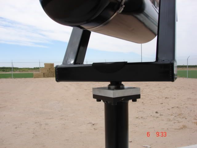

It would be impossible to fire without a mount. I also built another mount so I could load the gun (with minimal effort) onto my pickup truck and haul the cannon and CO2 tanks out to the desert for some long range tests.
<img src="http://i145.photobucket.com/albums/r240 ... 1244479624">
The vertical pivot mount is attached to an aluminum flange containing 2 front wheel bearings back to back (1994 chevy 2500hd Hey...on a farm you use what ya got). The aluminum flange bolts to a mating flange on the dolly and separates from the dolly flange with 4 bolts. The truck mount has the same mating flange as the dolly. It's "L" shape and plugs into the receiver hitch of the truck. The cannon can be moved from the dolly to the truck in just a few minutes.
