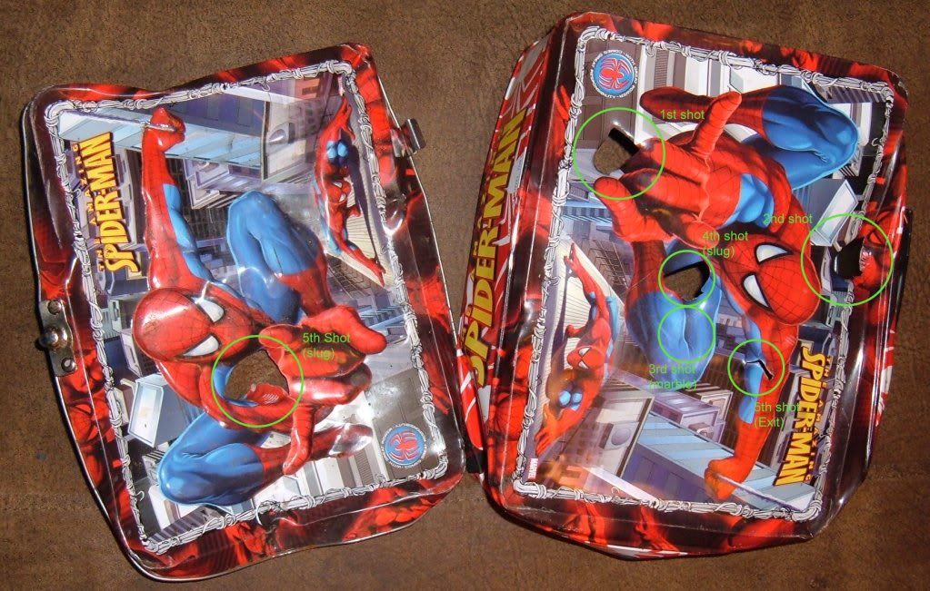

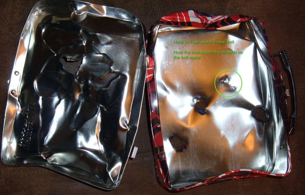

You should be going through that lunchbox like it was made of warm butter, shame about the sub 300 psi pressures... but good accuracy at 50 feet for a smoothbore and homemade rounds.
Actually, it was going through easily enough, part of the problem was that the lunchbox had the hinged side towards the back for most of the shots, The first shot almost ripped the hinged side off entirely. Another factor was my backstop, as the lunchbox was usually placed directly against it, so I have a feeling that hindered full penetration.
In that last shot on the video, you can see where it just started to punch through the backside, I also wised up and put the hinged side in the front for that last shot, so it wouldn't just pop open when I shot it. Next time, I'll be sure to watch for little things like that.
Just another tidbit of info: The last shot was actually about 190-195 PSI, as my bottle's pressure had dropped. I filled it to 220 PSI for the shoot, all those shots were on a single fill. I also took two shots at a can, but cut it out of the video because I completely missed the can both times and was just punching holes in the plywood behind it.
