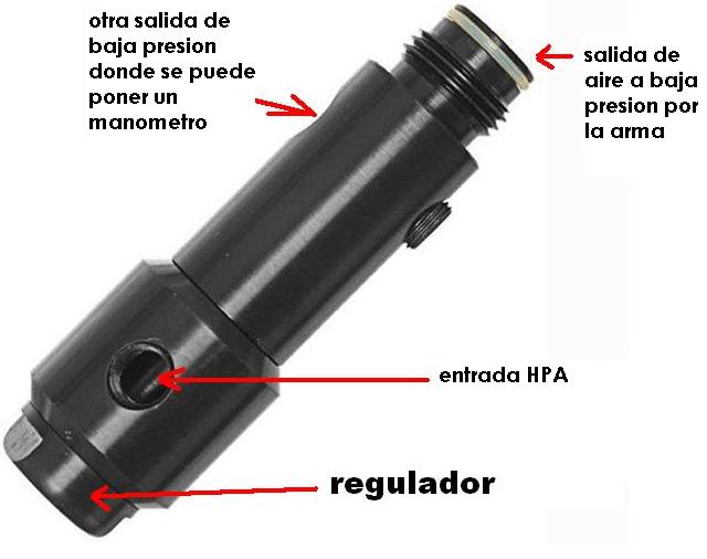

As maklaw pointed out, it's not very polite to converse in spanish on an english speaking forum, so we'll leave it at that
