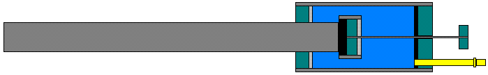

I had never posted these.
Wow another vintage QDV. Did it have a sliding piston on a rod?
Looked something like this internally, unlike yours it wasn't a balanced valve:
