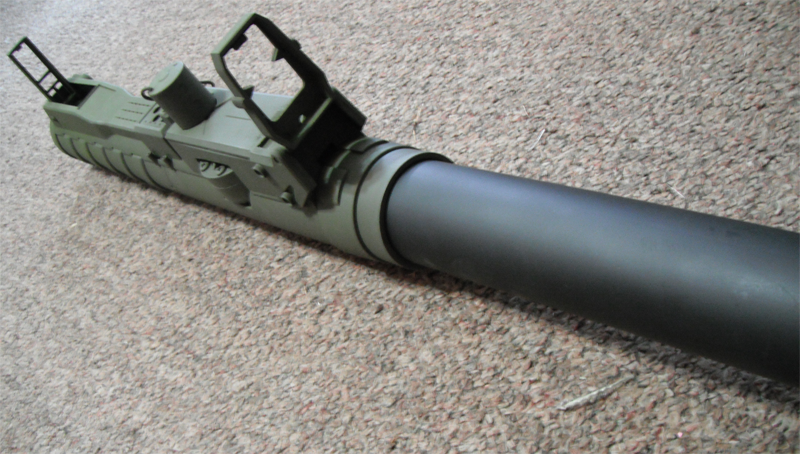

Update: here are some pics of the body after the installation of the sprinkler valve, but when I woke up this morning, one of the two wires that comes from the solenoid popped out. I am looking at the solenoid and I dont see a way to take it apart and I doubt I could fix the wiring cause it looks like it receded into the body of the solenoid. So I'll just have to get a replacement solenoid which is fine, I was thinking about picking up another sprinkler valve anyway.
I made the launcher around the idea of modularity, so I can take each individual part off of the launcher, so I can remove the solenoid, the sprinkler valve, the air chamber, the barrel, and even the electronic control unit. So when issues like this are involved, I am not worried.
Here are some pictures, The current chamber is PVC, but I will have a secondary metal air chamber as side precaution in-case I go to a field that I have never been to.
My air chamber is still not finished as I have to make it the right length, and install the cap/fill valve, and the relief valve.
