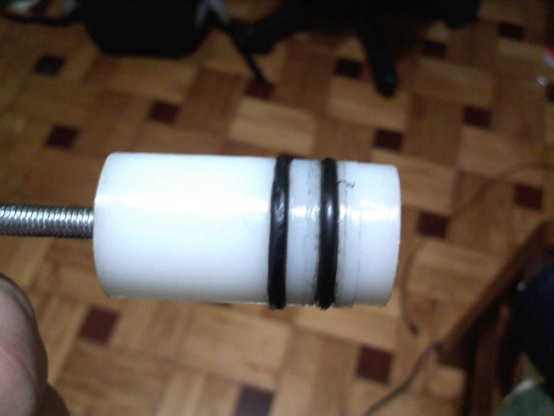

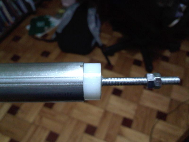

So I made a kind crazy decision: make my own valve, with o-ring seal. The advantage is obvious, I can fix the valve on the chamber with screws and when I have to repair the valve, I just have to unscrew it. Well, I made the valve out off nylon, because I don´t have a metal lathe, only my drill press.
Anyway, I made it :P , with 2 o-rings(still need to make the internals). Now I won´t be using 1000 psi, only 60 bar. The area is about 3.33 cm2, at 60 bar it will be 200.4 kg. I´m not worried about the valve blow up, but the screw part, where shout I place the screws?

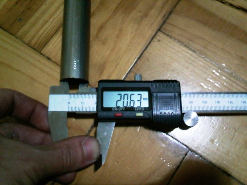

Chamber ID
