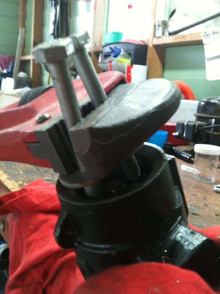

Build a drum spanner. The outside dia. should just fit the port and a center hole to just fit over center shank, then 2 for bolts or steel dowels to fit the holes to turn out the part.

If you have a vice..clamp 2 bolts in the vice ...really hard...
Take hex head bolts and put on enough nuts to create some mass for the vice to grip onto.
Turn them so the angles line up and clamp on the flat surfaces.
Make sure they fit into the snake-eyes..
Then put a pipe in the bottom of the Tee to use as a handle.
I had thought about this but the nail punches I were using kept slipping out because I had to wedge something in between them to get the right spacing but your suggestion sounds worthy of a try because I could probably find some nuts that will thread on to the bolts to give me the right spacing and enough surface area for the vice.
Clever, if the bolts wobble a bit they could be set in some softwood, and the wood crushed in the vice, to fix them properly.
My vice has a fairly small gripping face so I might grab two pieces of wood and stack the bolts in the vice vertically instead of horizontally (like above) as they would be less likely to slip out of the vice that way.

With a better look, there seems to be a green substance on the plug, I'd sure it's loctite. Over such a large area, it'll be pretty tough to shift.
Good eye, didn't think about that.
So I think I have a few options that should all theoretically work, I'll start work on it shortly :wink:
Tue Feb 12, 2013 7:13 pm

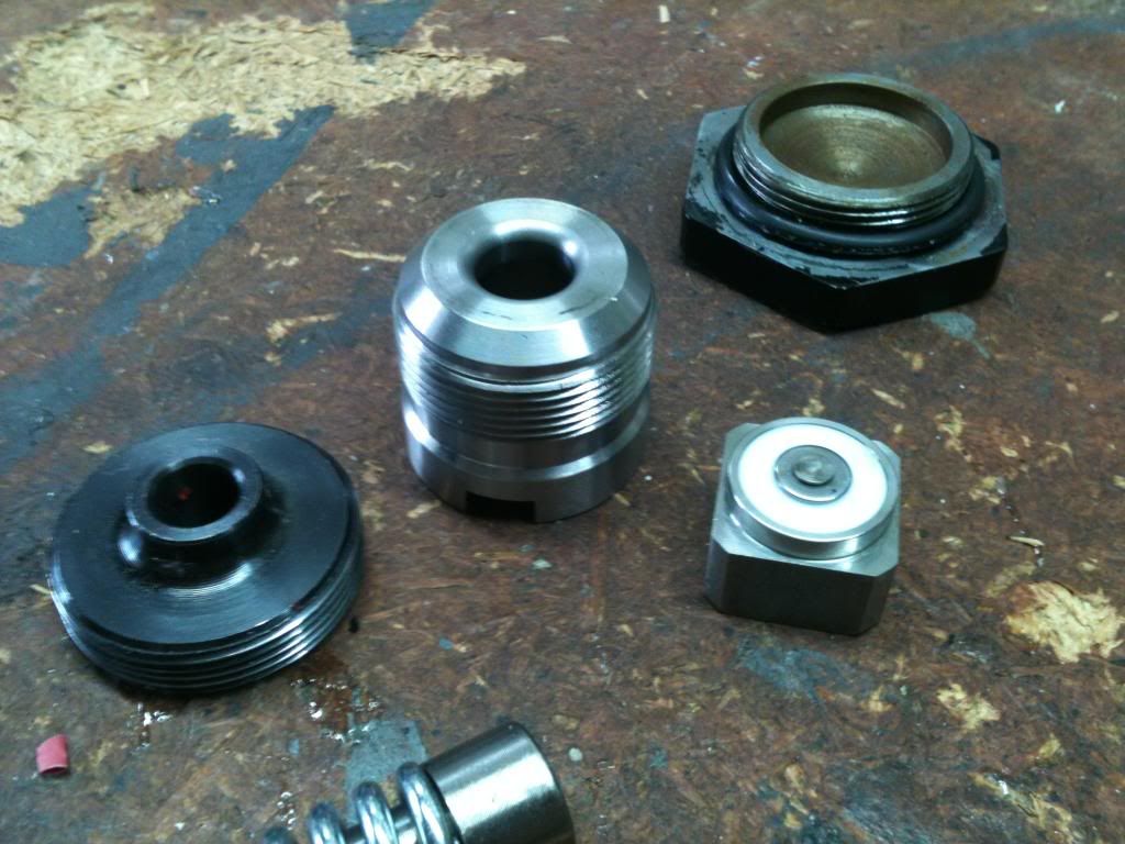

Well I got it open. I drilled bigger holes to poorly threaded a bolt in each hole (without a tap) and then used a big plumbing wrench to grip both bolts and unthread the plug.
I was thinking from the outset that the valve could possibly be used for a piston hybrid cannon but the uncommon internal threads makes it difficult. The plug/end cap thread is a touch smaller than 1.25" N.B. galv. iron thread and the thread for the removable valve seat is a touch over 1" N.B. galv. iron thread.

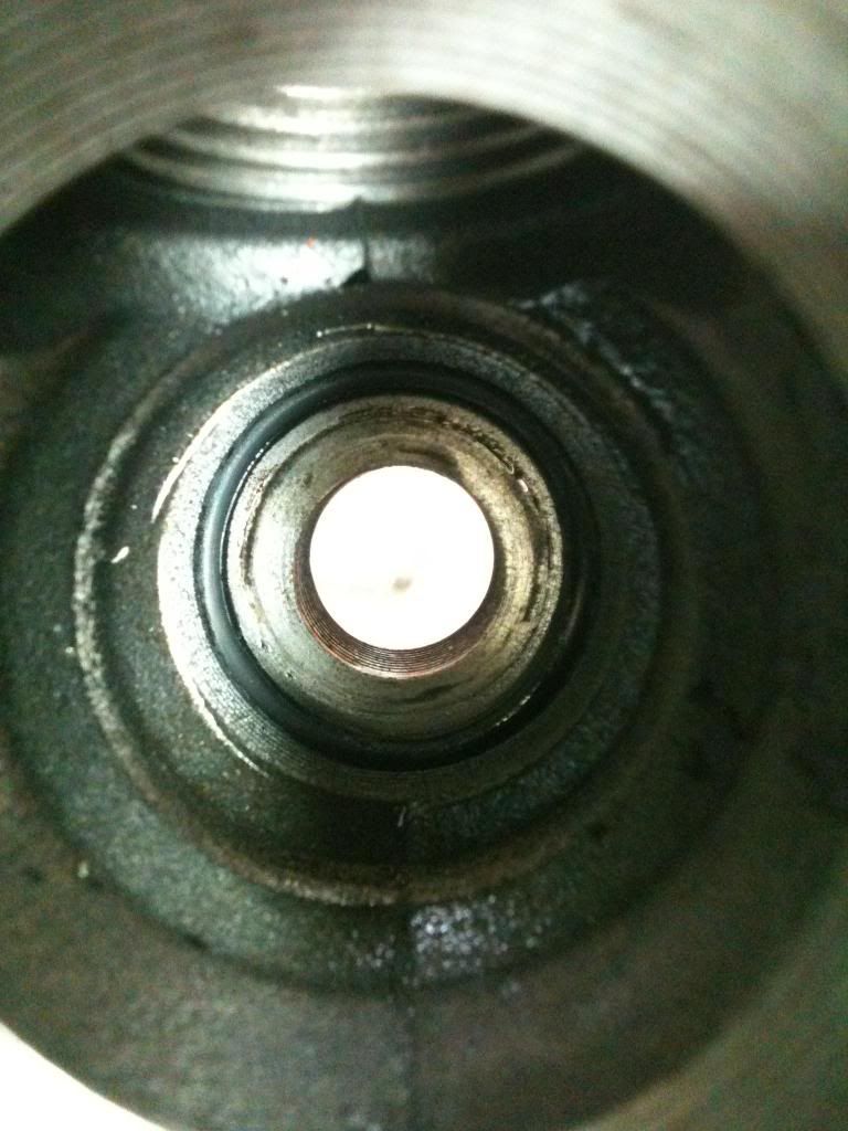

Looking through the back port towards the front port (the o-ring is where the removable seat threads in and seals against):

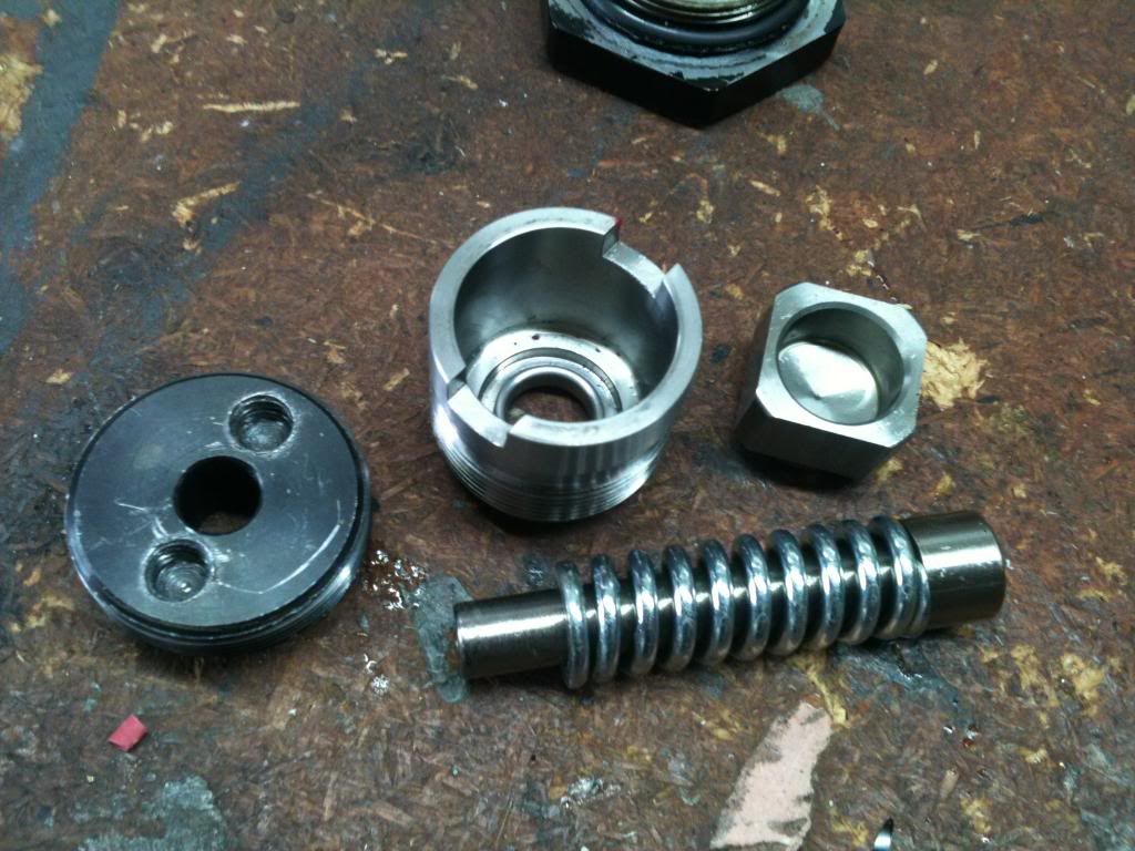

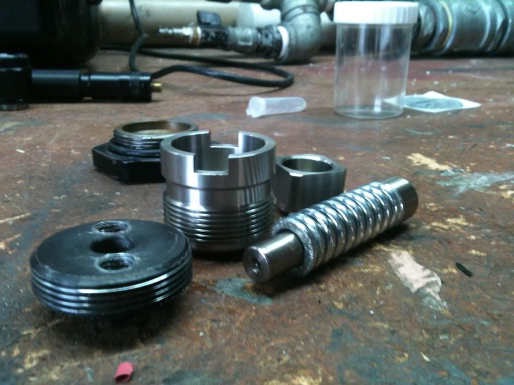

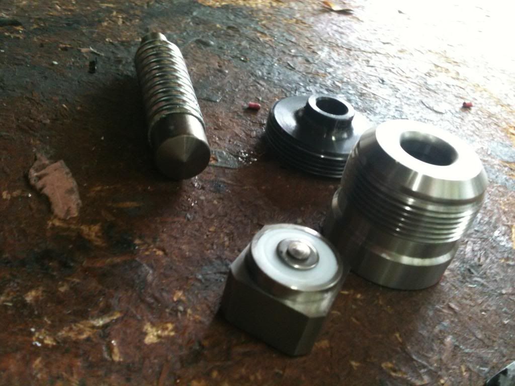

Any ideas? Clearly, the valve doesn't have flow in mind as the 'piston' does its best to take up as much space as possible (being square instead of circular), leaving only a small amount of room around it for gases to escape around. Though, I think there's some way I can make it useful if I remove the piston, spring, and bolt thingy and make something else myself.

MrCrowley wrote:Any ideas? Clearly, the valve doesn't have flow in mind as the 'piston' does its best to take up as much space as possible (being square instead of circular), leaving only a small amount of room around it for gases to escape around. Though, I think there's some way I can make it useful if I remove the piston, spring, and bolt thingy and make something else myself.
If I got the configuration right, it would make a killer HPA auto pop-off...

Well you were right about that. When I bought it I thought it wouldn't make a great pop-off because of the low flow but I just tried it at 160PSI and 240PSI and I'm quite impressed. With only my track pump hooked up to the inlet it would pop at 160PSI and re-seal extremely quickly at ~140PSI, even though the volume of air from the pump's check valve to the relief valve inlet wouldn't be much more than a tablespoon's worth.
It's also very easy to adjust and you can do it without a spanner as the end cap's o-ring proves adequate when tightening by hand. I think the valve was originally set at 250PSI (with a maximum of 300PSI according to the spec sheet) but I adjusted it as far as it could go and it didn't show signs of popping at 320PSI.
I think it would probably only be useful for shooting light projectiles like paintballs because it only releases a small volume of air. Though, you could always use another spring or add some spacers to up the pop-off pressure and use it with unregulated CO2. The only worry might be the plastic sealing face but that could be replaced with something that doesn't mind cold temperatures too much.
