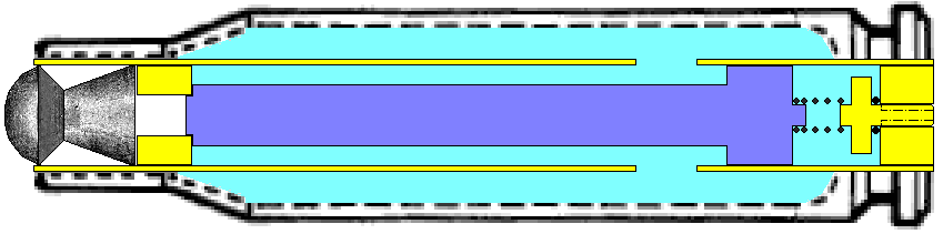

Just a niggling thought, converting a 7.62/308 cartridge to pneumatic using a 7mm OD tube insert:

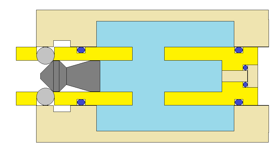

Revisiting this idea in my head, looks to me that a variation of the Saxby Palmer with a balanced spool would make a lot of sense. There's still the o-ring friction but nothing like the force of keeping a poppet type valve closed, which would mean less force to open it, so the bolt spring might be weak enough to allow for shell ejection and therefore potentially semi/full auto fire...
edit: alternative configuration with greater internal volume:

You would have to reverse the fill plug on the last design.

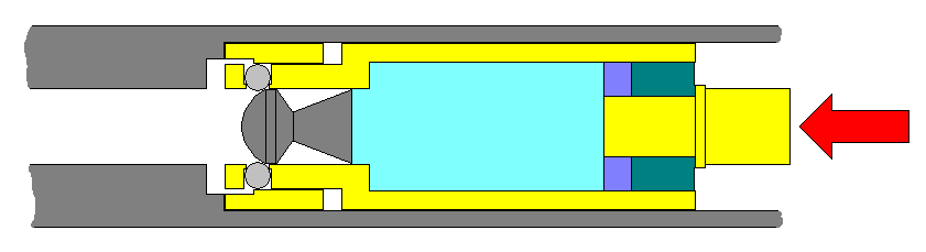

Some more idle musings, combining the locked projectile "valveless" design with a balanced spool. The problem with the latter is that even in small calibers, beyond a certain pressure it becomes far too difficult to actuate when made like this, however if you incorporate in a system where the friction is being balanced out in the opposite direction it should make it relatively easy to fire without too much effort.

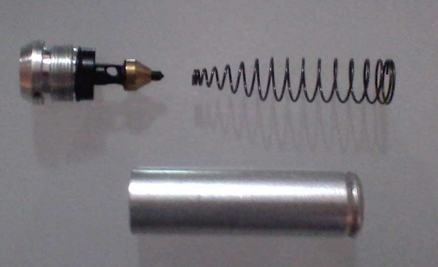

There is nothing particularly innovative about the cartridge mechanism, it's a balanced spool that is hollow, hammering the base of the spool exposes ports at the rear which allows the air to vent through the hollow spool into the barrel:
This is virtually identical to the airsoft APS APM50 cartridges:
