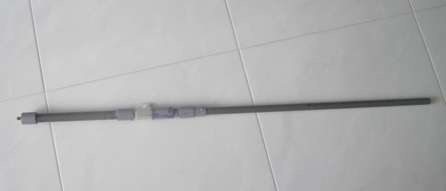

Update:
Gun design has been changed. One has already been built by my juniors under my watch. As usual, <15 minutes work, <S$10.
We do not do damage videos, we are not so destructive unlike you guys in the West. At most we fire at ballistic gel.
Below are the pictures of the gun:
These are the following changes that we have made:
- 1/2" (nominal size) AW/VP JIS PVC pipe chamber instead of soda bottle. Cost only increases by about 30 cents. Chamber volume is now 30-40% of the original, C:B ratio improves from >1 to about 1:2.5 (est).
- Decreased barrel pipe size from 16 to 13mm. 13mm AW/VP (i.e. pressure rated) JIS PVC pipe is ideal size for firing AA batteries, while 16mm is too big.
The performance does speak for itself. Despite the much reduced chamber volume & the dead space caused by having to add a 16-13mm reducer fitting there, the downsizing of the barrel causes the performance to still about 75% of the original, on half the pumping.

- The gun. This was built by my juniors under my watch, hence the sloppiness (PVC primer running all over).
- 1.jpg (12.83 KiB) Viewed 2517 times
Hell that actually looks like fun, put a simple stock on that you have a nice modest little plinker.
I'm not even sure why, but I have an enormous craving to build one...
Yes, I also thought of adding a stock and aiming sights too. However, this is a basic design.
I forgot to include, the ball valve is quite hard to turn. Lubricated it with a bit of cooking oil, substantially solves the problem.
I should have had a longer barrel in both and a elbow to connect the chamber........both are inherently inefficient, I conclude from firing tests that a lot of air is being wasted.
When it concerns simple mass producable stuff like this, we operate like Soviet Russia here: Simple, cheap & mass producable, and then users then go modify their guns to best fit their situation.
Hey, if you have an enormous craving to build one........it's only 10-15 minutes and $10 (I assume)........
I like this much better than your original. However, you could actually use a little more chamber. Going up to a 1" chamber and the same length as the one above would show noticable performance improvement. It wouldn't cost too much more. You would need a 1" endcap and 1" socket to 1/2" threaded adapter to connect to the same ball valve...really a minimal change.
Yes perhaps a somewhat longer barrel, maybe 6-12" but don't go too long. These should be practical and cool, not monstrosities that draw too much attention to themselves.
