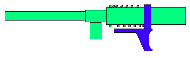

Here's a basic idea of what you should be aiming for, green is the barrel-valve-trigger-chamber, purple is the part that rests on your shoulder and grey is a spring.
It's unlikely you'll find a coil spring that big that won't be too stiff, but as I said, the spring can be replaced with a gas strut that can be found reasonably cheaply on eBay or from your local automotive outlet, bungee chords or slingshot elastic are also a viable solution.

I see, I am gonna wait and see how bad the recoil is then decide on what to do. I was originally trying to weld a track system to the bottom of the chamber and have a single gas strut.
Not sure if that would work since it would not distibute force evenly.
