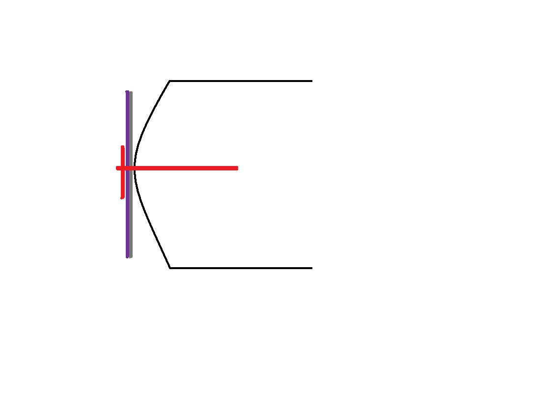

Okay, diagram time.
Bolt and Washer
Sealing Face
Metal Disk To Support Sealing Face*
End Cap
*Turns out this doesn't have grey, so the grey in the picture is subsituted for the brown in this post. Grey = Metal Disk. :)

Do you mean the end cap or the pipe the piston is housed in?
If you mean the latter, just find a disk smaller then the I.D of the pipe but has a larger diameter then the sealing face.
If you mean the end cap, just stick a washer between the disk and the end cap.
