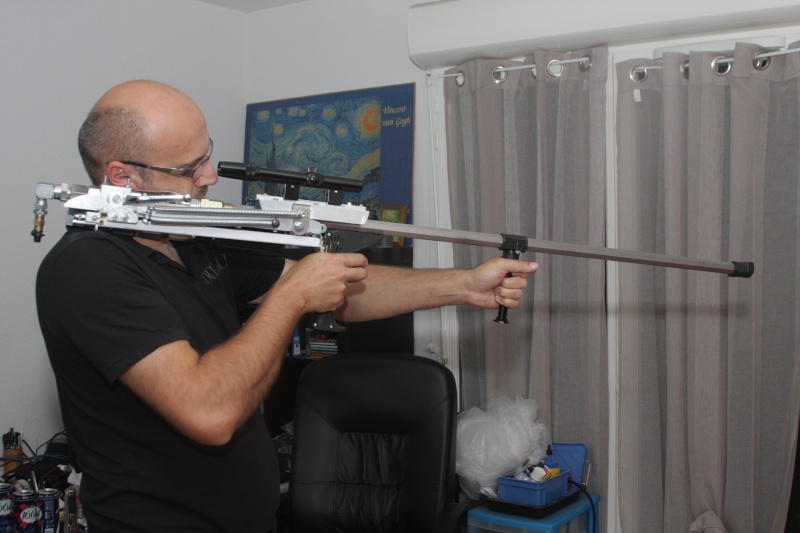

I modified the gun by welding above a sleeve 1/2 BSP.
J'ai modifié le canon en soudant un manchon de 1/2 BSP.
With bullet :
With out bullet :

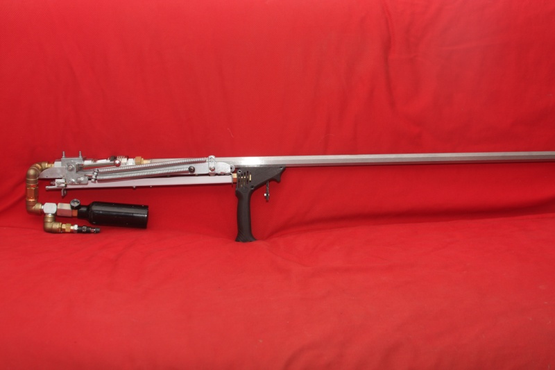

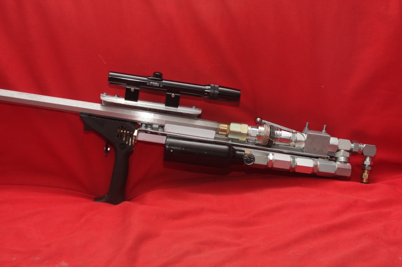

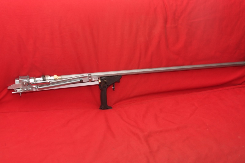

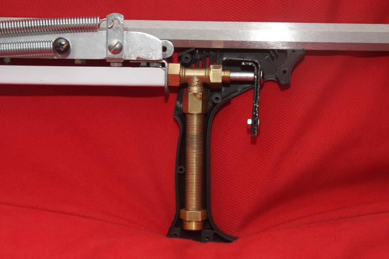

here the continuation of the transformation of my PAC 3000psi into bullpup.
There, the brass connections are temporary and will be replaced by connections high pressure
Your screw?
Fri Oct 07, 2011 12:16 am

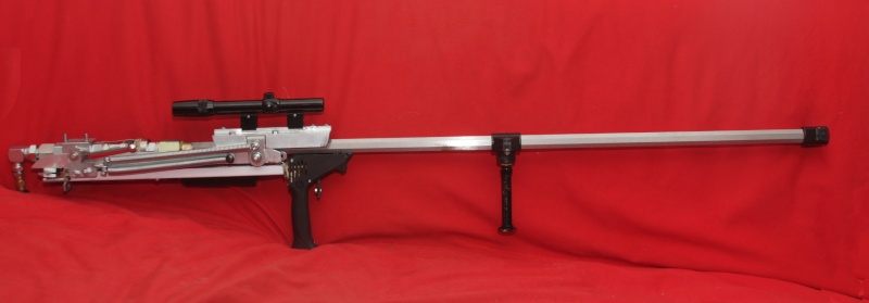

Much better, nice and compact - and I see you've gone for a more reasonable chamber size. Just needs a decent butt plate, scope mount and maybe a bipod - plus of course a full length integral suppressor :D are they legal in France?

Thank you
decent butt plate is envisaged, the PAC is not finished.
For the regulator of sound it is not interdict in France but difficult to realize...

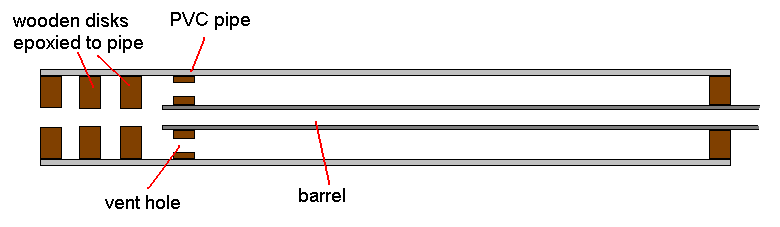

Petitlu wrote:For the regulator of sound it is not interdict in France but difficult to realize...
An idea?
The easiest would be a tube over the barrel, and some ports at the muzzle end:
Still, I wouldn't want to drill holes in a lovely barrel like that.
Maybe something like this?

really very interesting, it is an idea to be explored.
Thank you
And would the sound be very reduced?
An idea?
In the first diagram, i thinks if the holes are closer the muzzle of barrel it's better, the air will ahve the time to enter in silencer chamber, while the bullet continue its travel in silencer internal pipe.

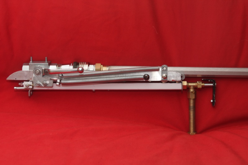

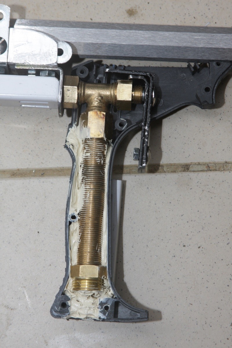

Continuation :
I received the HP connections:
