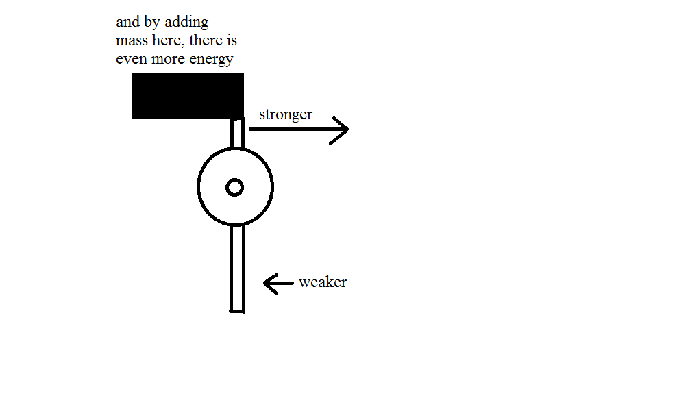

I used a rotaing hammer because even with a weak spring, I can get enough energy to open the valve, by manipulate the point of application of the spring force.
Diagram:

Yeah, that makes sense. But the way my hammer is designed doesn't allow me to manipulate anything at this stage, which sucks, because I spent so much time on it. But I'm willing to make a new one that will work well.
