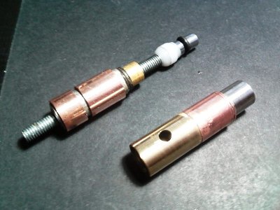

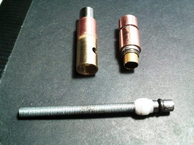

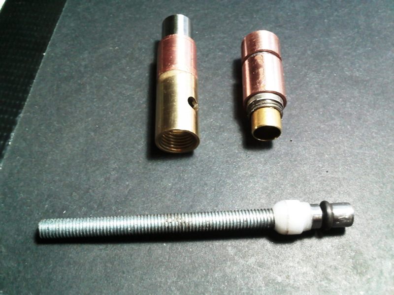

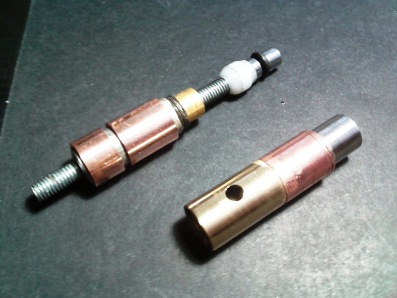

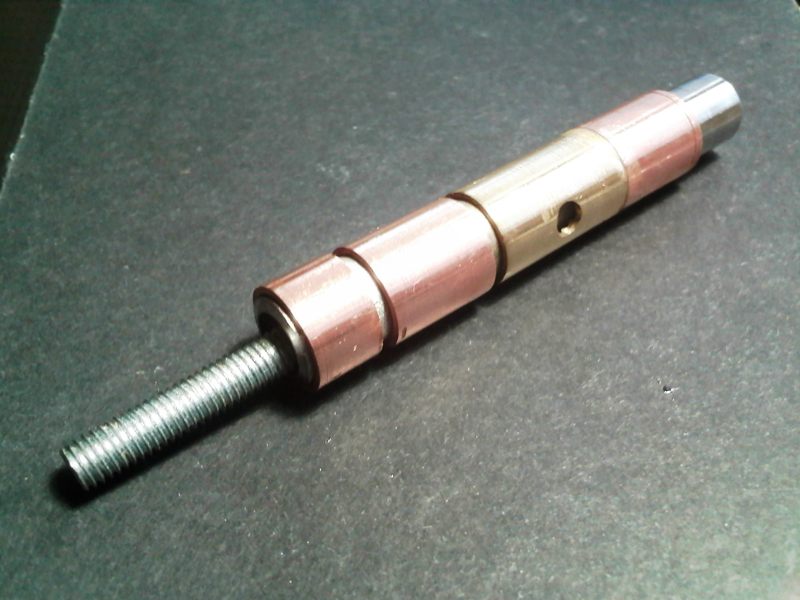

OK, I almost finished my counter balanced hammer valve :roll: (still need to make a cap, or maybe I will see if it allows blowback semi... Also need to drill the output port)
Full metal except the seal(nylon).
Haven´t try it out yet, also I have made a bad choice: use floating o-ring on the counter piston :cry: Now I don´t know if t will seal...
Pictures, if any of you see any problem, please tell me before something goes wrong :)
Netherlands
Posts: 3497
Sun Apr 08, 2012 3:12 pm
Apart from sealing problems..
how far can the valvestem move?
Looks like the nylon seal is in the way..
hard to tell from a picture..
The O-ring should be floating.
It should rest against the inner walls of the pipe it runs in and on the front shoulder of the groove,
It does fit very well inside the tube, should not have leaks. Didn´t understand the "on the front shoulder of the groove" part.
The valvestem moves about 0.5 cm. Good flow, the nylon isn´t on the way.
