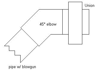

I was just thinking the same as ammosmoke. A blowgun should be able to pilot this valve quite nicely. By adding a blowgun valve only, the pilot could also be cut down. I sketched a diagram for you.

hmmmm i like that idea but im out of $$ right now so maybe later :lol: . but thats a good idea.
