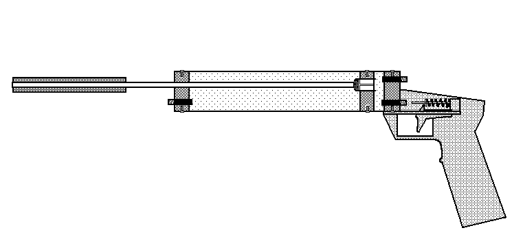

The lighter valve will definitely not have enough flow to pilot your piston, if you keep your piston travel to about 0.25 times the barrel diameter even a schrader valve will be enough as a pilot, meaning you can have one valve to both fill and fire it.
It's a better idea to have the barrel on the removable endcap, that way you can still remove the piston but it will allow you to have a minimal pilot volume.
This is my first piston cannon design, the only epoxy I used was Araldite (you can use JB weld or similar) and it was good for 80 psi at least.
The design below used a separate schrader valve for firing in order to make it more ergonomic, with the schrader struck by a spring loaded hammer released by the trigger. A simpler way of doing this would be to stick a blowgun into the back end instead.

Hmmm...well I'll tell more about that lighter...
All the lighters have some parts in it to help make a smaller flow to have a nice candle-sized flame and lets no liquid butane out.
But when I removed all but the main valve, it empties a lighter in 3~5 seconds...
If that still isn't good enough what would be the 'minimum' pilot volume?
And @ JSR's drawings:
Balsa wood? 0.o Is that air-tight?
And wouldn't the rubber thing in a syringe move too slow?
Edit: Oh does that design need to be pumped at 2 valves?

Tsukiten wrote:If that still isn't good enough what would be the 'minimum' pilot volume?
The simple fact is that if more air leaks around you piston than can escape through your pilot, the piston will never move. I would play safe and stick with a schrader valve at least.
Pretty much, i used to put a layer of araldite on the inside surface to seal it well.
Not really, the small (5-10ml) syringes normally have low friction and move fast enough. You can always use some water-based lube to help it along.
Since the syringe seal is 100% airtight, yes. Alternatively, you can have a small equilisation hole between the chambers.
